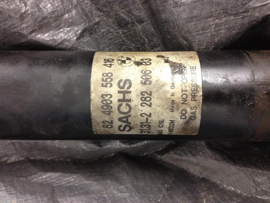

            I couldn't resist the temptation to measure them.
            s.mac we agree on the dimensions.
            I made this pic, if you think something's wrong, please let me know and I will update it.
