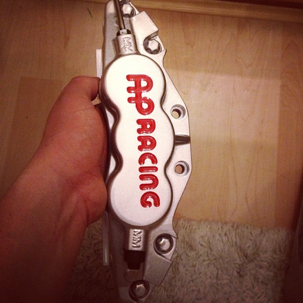

Buy seal kit from questmead and replace seals by yourself....
if I can do it anyone can - even Smac
tools needed
footpump
block of wood (to chock the pistons as you pump)
blunt flat bladed screwdriver, to pry out seal
plus gas/dismantling fluid
maybe a source of heat to loosen bleed nipple
8 or 10mm socket for nipple
brake fluid
brake cleaner
I then got a mate to paint mine gloss black, i think it cost me a few bacon butties and some beer
