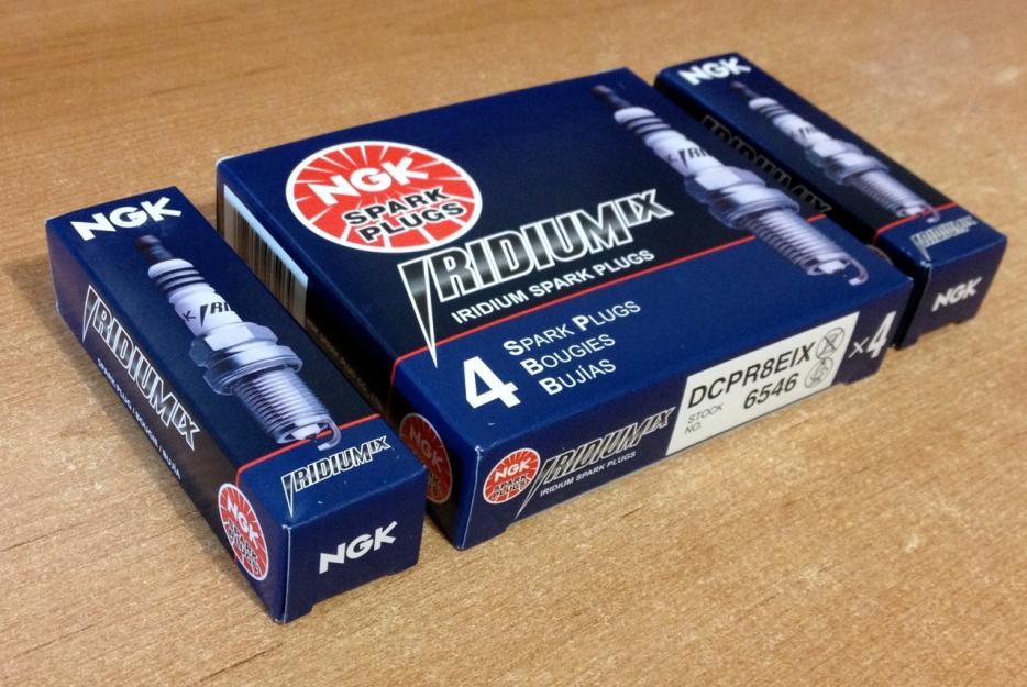

    Previously it was due to cheapo lambda's fitted, a change to new genuine ones sorted that. On my way back from Devon recently it started pinking a little on part light throttle. Before going down the compression / leak down test for HG issues I thought I'd take a look at changing the coils and plugs. In short there was a mixture of old bremi and 1 new bosch coils so I changed them all for new bosch ones (£17ea ebay). The plugs were well worn ngk dual electrode ones so I changed them for a full set of ngk iridium ones (£38 per set ebay).
    The car now starts and idles so much smoother, unbelievably more I'd say. It's super smooth on the road too. It's not been this smooth to drive since I bought it. NO pinking either :supz:
    Just a pointer if anyone else is or does in the future experience slight pinking, MAYBE try this first :-D

            UPDATE: NGK IRIDIUM spark plugs
            Originally posted by J2LTB View Post
            Brilliant. Found this thread at the top of a search. I've ordered from the same eBay seller. Did they take long to come ? :beer:
            Quick update: Ordered mine last Friday afternoon and they arrived first thing this morning. Great Service from the before mentioned eBay seller :thumbs:

                You're such a pessimist sometimes Shimmy :wink: :hahaha: These are "Made in Japan" and come with 12 months warranty :thumbs:

                            I'll tell U tomorrow mate :thumbs: Cecil's still @ Elms Cambridge... although if you read the previous posts in this thread, others have positive results with these + NGK recommend these as an upgrade over the OEM NGK R Platinum :beer:
                            Here's a comprehensive explanation from NGK: http://www.ngk-sparkplugs.jp/english...ium/index.html

                                They certainly made a MASSIVE difference to my car but that was likely down to one or more duff original plugs or coils. Maybe you won't notice anything, maybe that occasional stumble at idle or temperamental running when in the warm up cycle will be reduced or sorted. It's just nice to know that such a highly tuned /strung engine has the best plugs out there fitted. For under £40 too :thumbs:
                                I'm not connected to the seller in any way either :hahaha:
