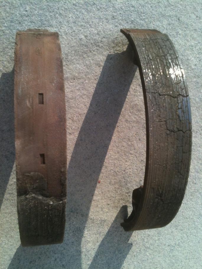

                              I wonder what my rear handbrake looks like?
                              I would guess like this!
