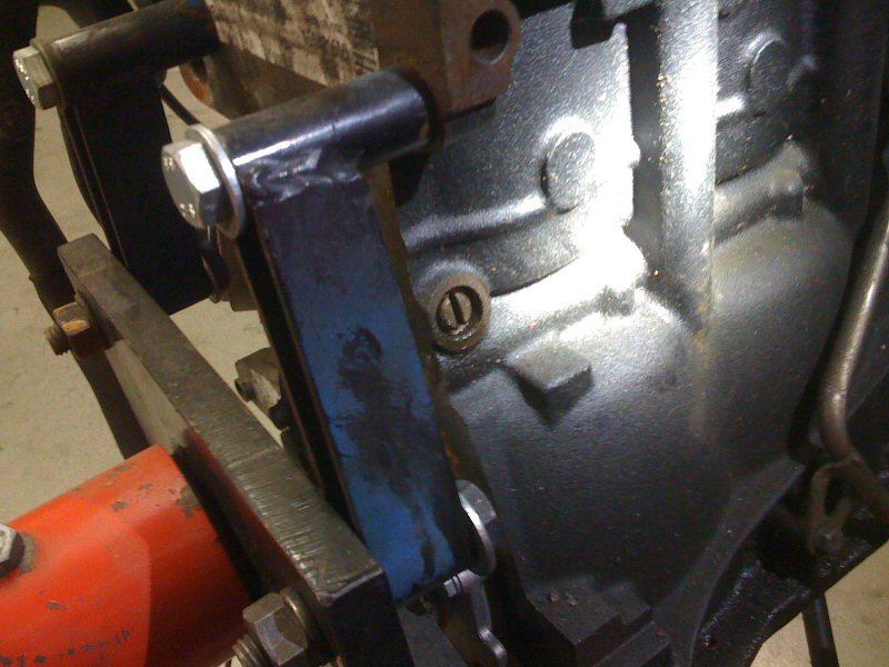

    The most common culprit in this area is the pressure valve on the block, under the bank 2 exhaust manifold.
    number 10 on this picture. You can just about see it with the metal undershield on - there is a little cooling flap just behind the drain bung hole you can look up with a torch.
    Might be worth just haveing a check again and see if it is that valve, if not & you confirm it is higher up then I would recommend taking the microfilter housing off so you can see with a telescopic mirror.

      Yep pressure valve for sure!
        From your description it doesn't sound like the CPV (although that is the one that tends to leak all the time) - The CPV sits on the top of the block near the head not the valve cover.

          Hey thanks guys,
          Thats great advice, ill have a double check tonight, but from what ive been reading on the net last night and the info you have given me, im now convinced it must be the CPV.:bigcry:
