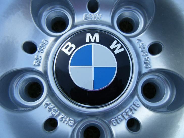

        BMW CSL Wheel center image:
        Note: beneath the 'M' badge (which is incidentally is upside down) 'BMW' is embossed, not a series of numbers.
        However, we've had this conversation before, BBS wheel sold by BMW, as opposed to what could be a 'BBS Wheel' sold by BBS is a possibility.

                The "M" badge is oriented correctly on those wheels - just when you read "BMW" on the wheel itself the "M" badge appears upside down (which is how they are placed from the factory.)
                Can you get better shots of the wheel please.
                There are aspects of these wheels that make them look genuine but also some strange anomalies (like the BMW insignia below the M badge which isn't very legible and I have no clue as to what it says).
                The two tone paint (compared to the outside and inner spoke) which make me think these are real (the correct colour also) - the random "X" "P" "1' ect marking on the inner face (although depending on the year the wheels are made some are cast into the face, others are stamped).
                I am leaning towards these are genuine at the moment, but need better higher resolution photos to determine for sure.

                  I think these have been refurbished - paint always seems to gather over some of these numbers when they get painted again
                  +1 for better shots, but I think they are genuine

                            It looks like the fronts are genuine but I suspect the rears are replicas as they don't have bmw stamped on them?

                              'rears' def reps
                              check on the back of the 'fronts' that they have BBS stamped in the triangle recess, and if so they should be ok
