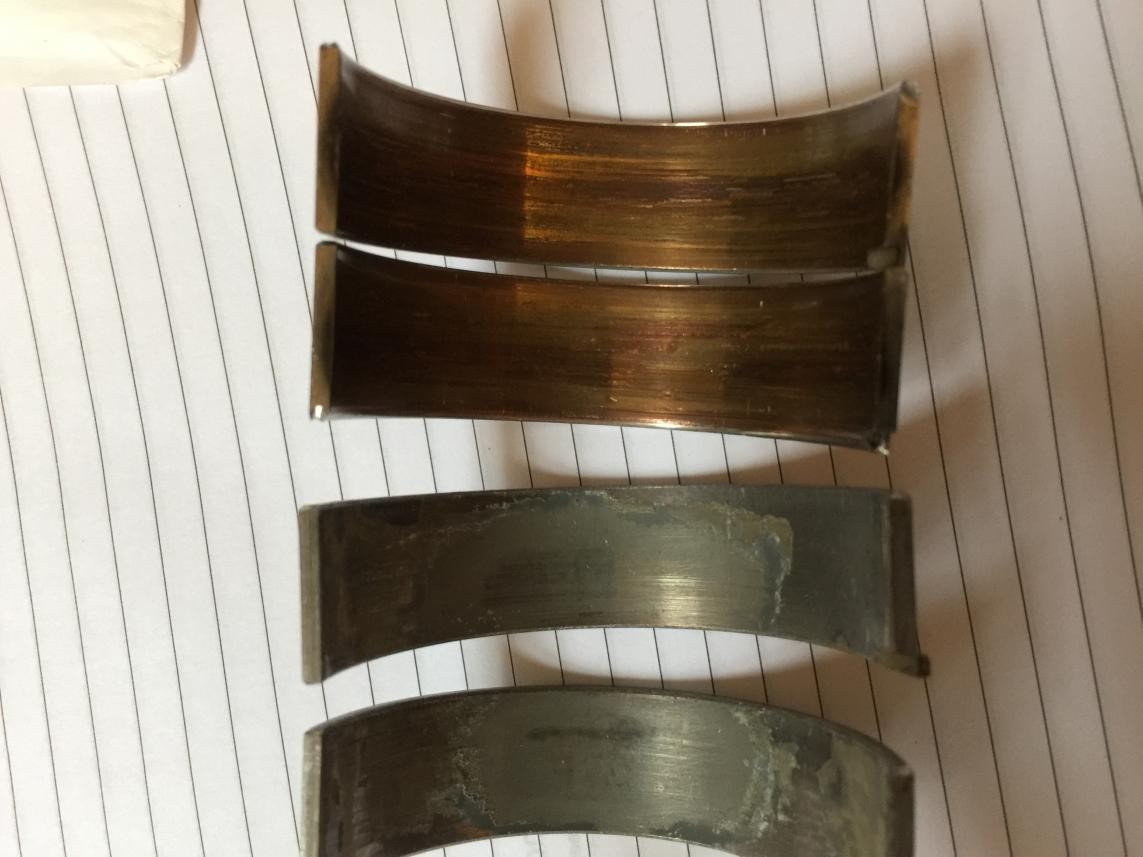

With regards to the original post topic (big end shells), I've only personally seen 2 cars fail so it is a small percentage.
