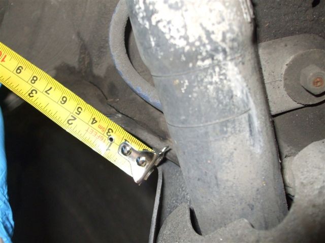

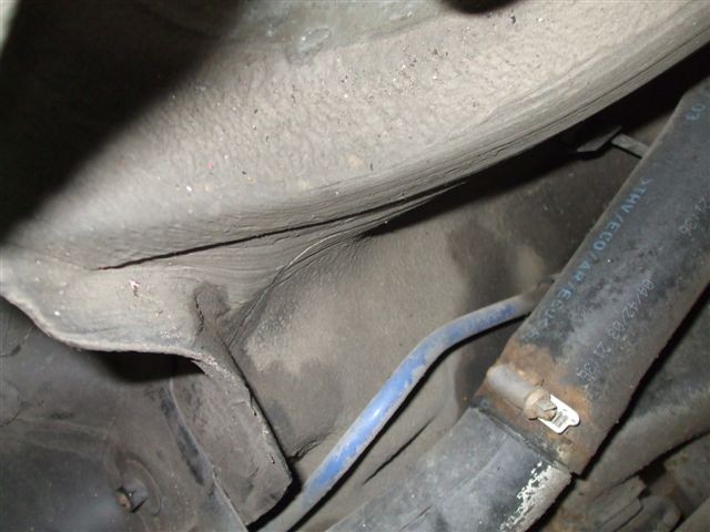

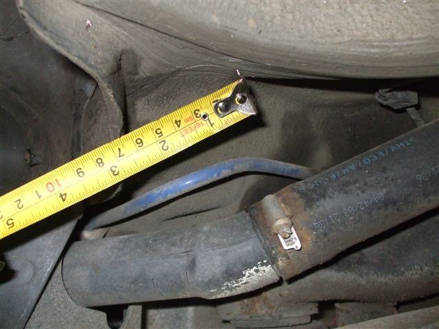

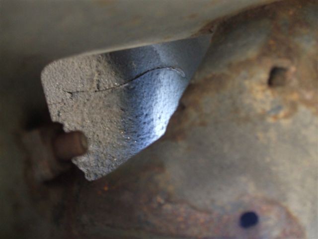

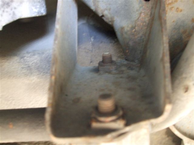

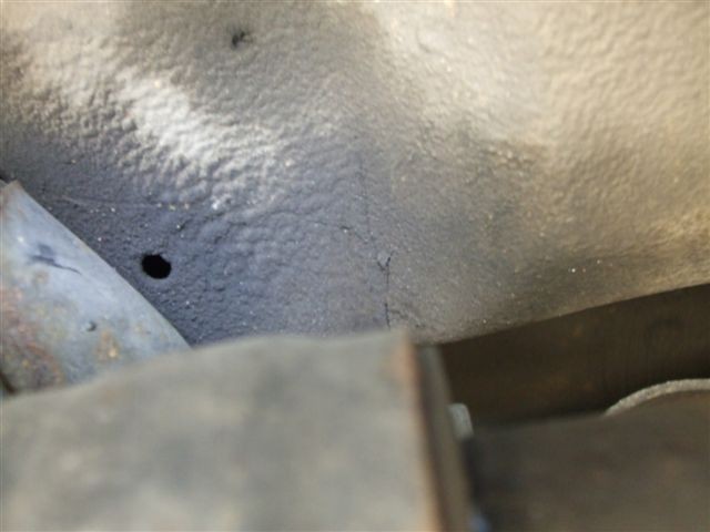

    This may help you locate them - here are photos of the cracks on my car that Gareth took for the warranty work to be done.
    FYI mine was checked as follows:
    November 2012:
    No cracks
    June 2013:
    No cracks
    September 2013:

        Wow, that's impressive!
        Thank you for the pictures Mike!

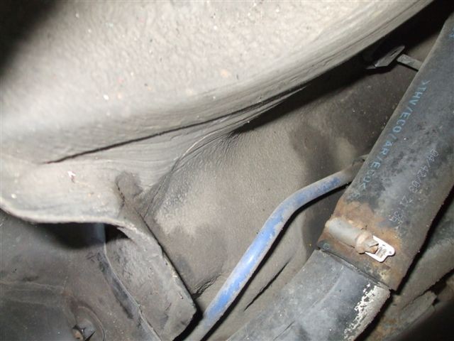

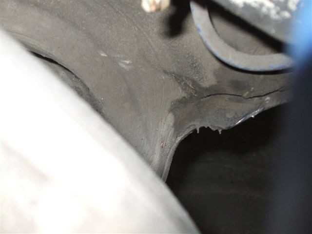

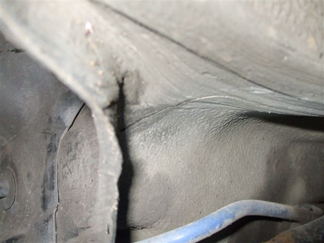

          Call them cracks !! Check these out on a car thats been driven by Miss Daisy all her life !
            #35

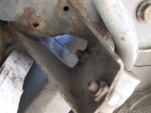

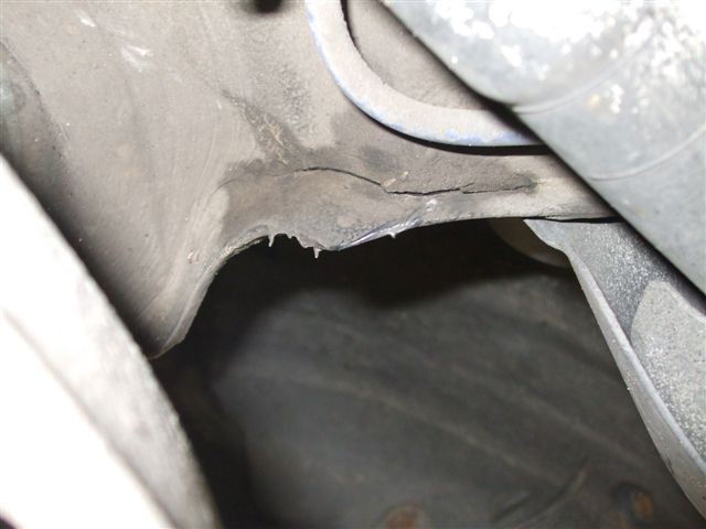

            few more..
              #36
              Final one
