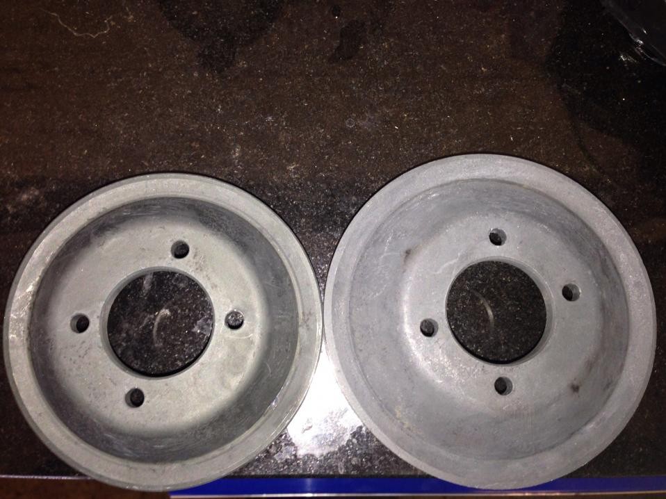

    I don't know if this is of any interest but euros do a smaller water pump pulley his could pump water round the system faster!!! Every little helps

            Can we find out the difference in the diameter ?
              12cm and 13.3cm
                Originally posted by adem.csl View Post
                12cm and 13.3cm
                So 37.69cm circumference vs 41.78cm.
                Therefore -> 10% higher rpm on the water pump which means 10% increased water flow.
                            It sounds good.
                            I am not very happy with the way they look though.
                            Is this how they really are (photos) ?
                            What???? If one has a 12cm outer diameter and one has a 13.3cm diameter where did you get 37.69 and 41.78?
                            The pic is at the first post

                              Alex was talking about circumference Adem, the distance around the edge. You'd quote diameter which is straight across the pulley.
                              Iirc circumference = 2x pie x diameter/2 = 2 x 3.142 x 12/2= 37.69 (I'm exhausted now)
