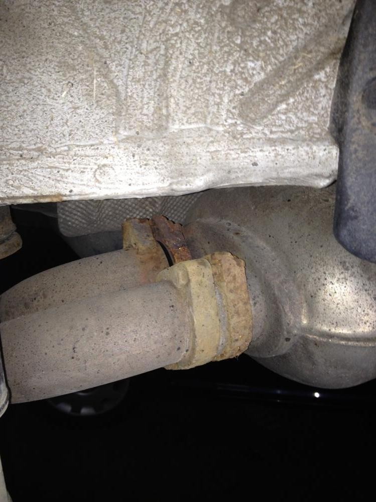

While I'm at my brake refurb I noticed the clamps on the exhaust where they attach to the back box r badly corroded and one is broken. Can these clamps be bought on there own or just with the exhaust ?
Exhaust clamps
The easiest and cheapest fix is to use Peugeot clamps. If you do a quick search there are quite a few threads with info.
The Peugeot clamps are readily available on ebay. You only need to do one side, the side where the clamp doesn't come off without grinding it off.
On the other side you can use new oem clamps and gasket.
good spot.......mine failed a bmw m.o.t. with corroded rear exhaust clamps.Originally posted by BrendanmckWhile I'm at my brake refurb I noticed the clamps on the exhaust where they attach to the back box r badly corroded and one is broken. Can these clamps be bought on there own or just with the exhaust ?
as above Peugeot clamps do the trick after a bit of hack saw handywork......
Mine needs doing too,luckily it's the one nearest the wheel,which as you said Steve,just slides off and you can use an OE BMW one,The inside one is a bugger to do and needs cutting and welding the new OE clamp,or take the Cutter approach and go Peugoet :-DOriginally posted by s.mac View PostThe easiest and cheapest fix is to use Peugeot clamps. If you do a quick search there are quite a few threads with info.
before you press submit,go down to manage attachments and it will ask you to upload photos,I think you have to write a short text with it though :-DOriginally posted by Brendanmck View PostWhat size of Peugeot clamps do I require are they a one size fits all?
By the way I took a pic of the exhaust how do I upload it ?
Same with me,but have sorted it now,take a picture of your iPhone picture,then post it up and it comes out the right way round.if that makes any sense.:hahaha:Originally posted by Brendanmck View PostHere's the damaged clamps .whats with iPhone pictures never come out the right way up!
I've got both my OeM parts in storage...............:thumbs: when you popping by!Originally posted by sydown View PostI had to fix both exhaust clamps recently, just bought 4 of the standard flanges from bmw, cut 3 in half and welded them back together on the pipe then painted with high temp paint! Looks better than the after market clamps but does mean both parts of the exhaust need to be on the bench!
