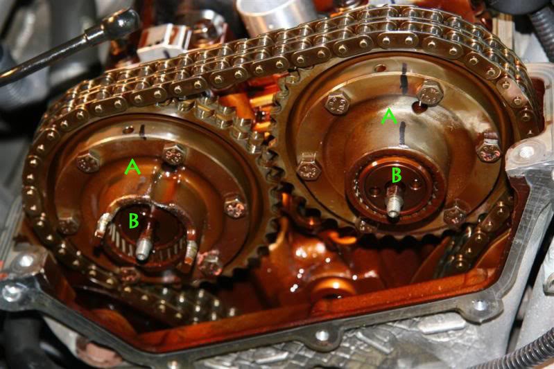

    Sorry I forgot to ask, so the process you were describing to check the cam bolts, that is simpler than removing vanos to get full access to all cam bolts? I did read somewhere that there is that short cut to check the tightness, can you get a torque wrench onto them via the short cut?
    If you have another minute.. vanos bearing/ pump should be checked or renewed. Will lead to bearing seizure and shearing of exhaust vanos lugs, and then the lugs can fall into timing chain? And a check/ replace of the small vanos filter is good too?

    Hi Dave,
    See attached photo. These are the 12 bolts that need to be checked. The are easily accesible with the rocker cover removed. The safest way to turn the engine over is to do so with a socket via the crankshaft pulley. Does involve removing a few bits though. You can leave the car in gear and rock it forwards also. If you do find any bolts loose it may be worth replacing them all. One at a time for obvious reasons There is a special tool to torque them up with, they should be 14nm.
    The oil drive you speak of is driven from the 2 lugs coming out of the exhaust sprocket on the picture attached (the left side). Not much you can do apart from visually inspecting them really. I've seen no failures personally.
    The Vanos filter is on the right hand side upper of the Vanos unit as you look at it, 22mm socket. Just pull it out with a cloth underneath, clean it out and refit. Replace if damaged.
