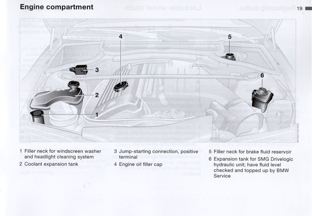

              Before you do mate, have a quick check of the fluid lever in your SMG expansion tank as it's know to seep past the rubber "O" ring in the cap and mist out slowly over time.
              Worth a quick look before our good Doctor "G" goes deeper.
              This is in the engine bay behind the near side headlight & XENON module (black box with wire harness on top (No. 6 in the pic enclosed) :thumbs:
