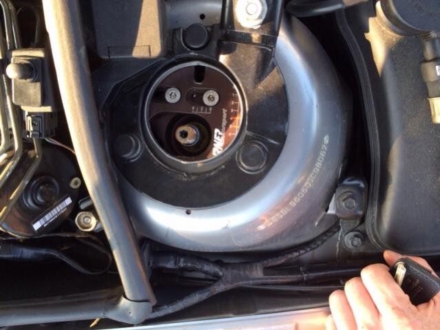

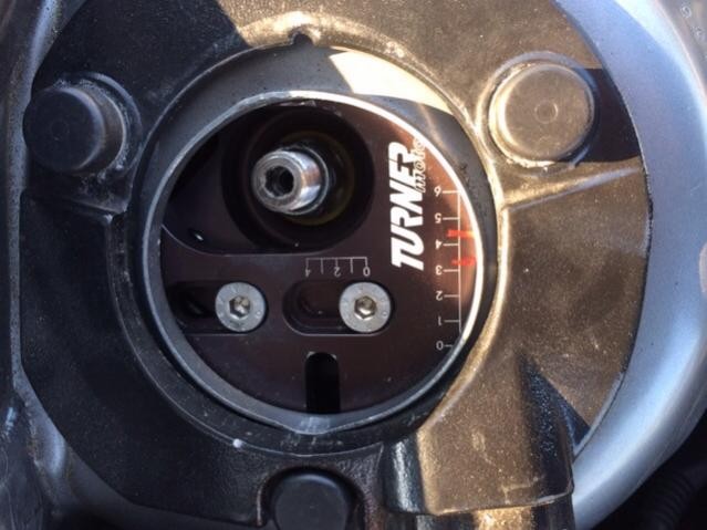

              Has anyone got a picture of their turner adjustable top mounts on the car they could post please. Simpson said they didn't check the castor and I suspect this could be the cause as it's set to the max setting, opposite to what turner suggest when fitting them.

                  Does the castor look right in the pics? It is set to the maximum fwd. so to adjust would move the shock top towards the back of the car and therefore more castor.
                  Got a track event tomorrow so might just move it to the other extreme and see if it makes a difference. Changing the castor shouldn't effect the camber setting I don't think but maybe the toe slightly. Worth a try anyhow.
                    Passenger side.
                      I think your current caster is smaller than the factory one.
                      Will take a photo tomorrow of the oem top mounts.
