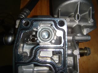

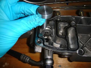

    Anyone got pics/video for fitting oil diverter valve just bought one for track car. Thanks
    install is straight forward, just remove the mechanical fan/shroud for access and than remove the oil filter housing and swap out the oem looking thermostat with this valve and put it back together. I believe this part makes the oil temp warm up slower which isn't a problem in the summer but it might be an issue for cold winter driving
    Getting the OEM thermostat out is pretty easy. There was a circlip that holds everything in place. Once the circlip was removed, pull out the thermostat which consisted of a spring, the brass thermostat, and a flange that allowed the circlip to hold everything in place. Then put the diverter valve in the OFH, put the flange on top of the diverter valve and then install the circlip to hold it in place.
