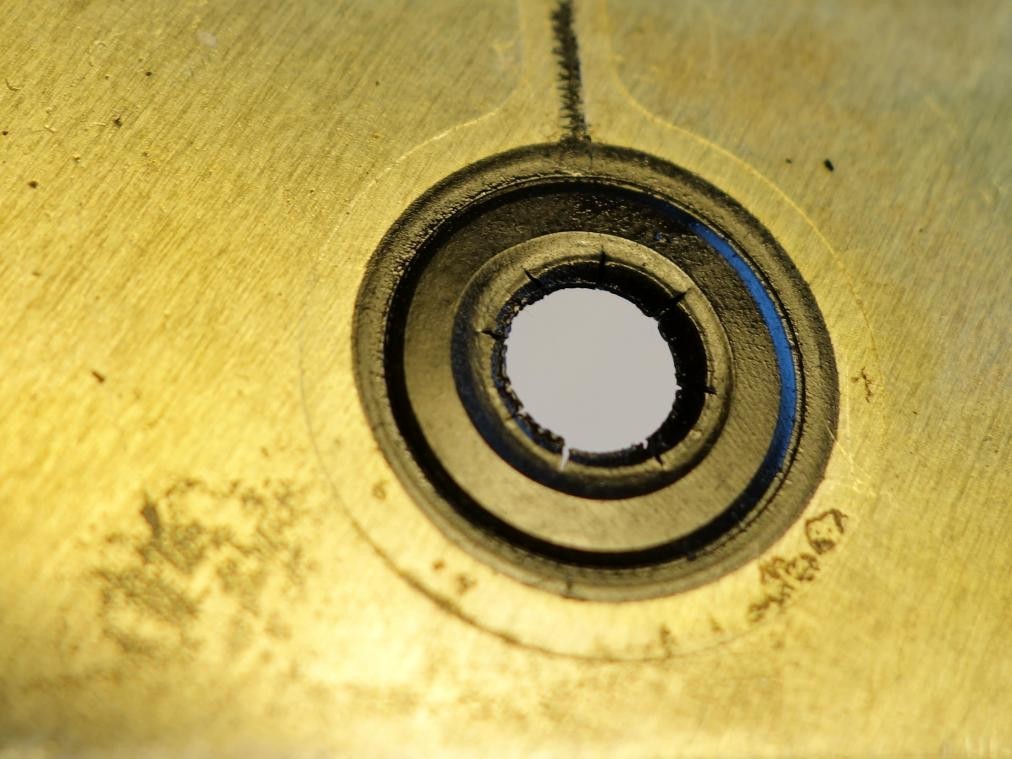

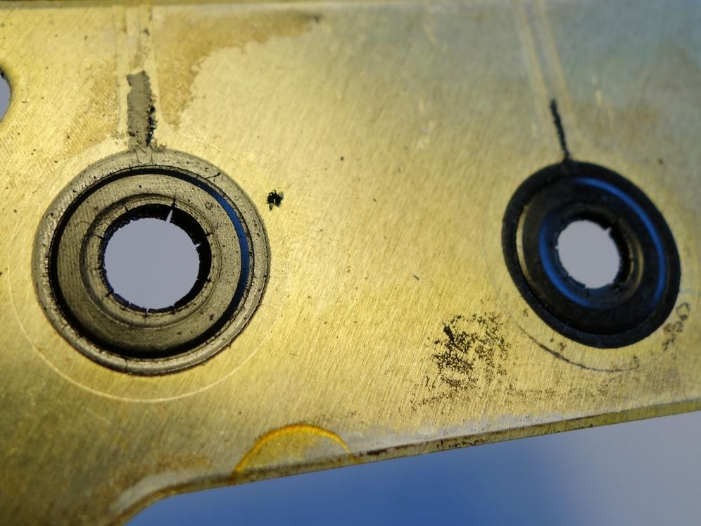

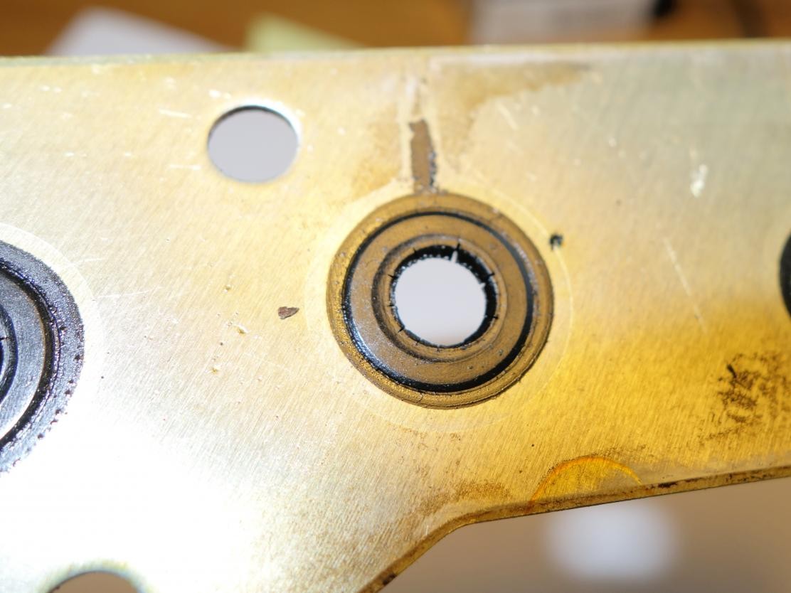

Here are some pics of the o rings on the sealing plate I removed, the seals were hard & plastic like & all split:
