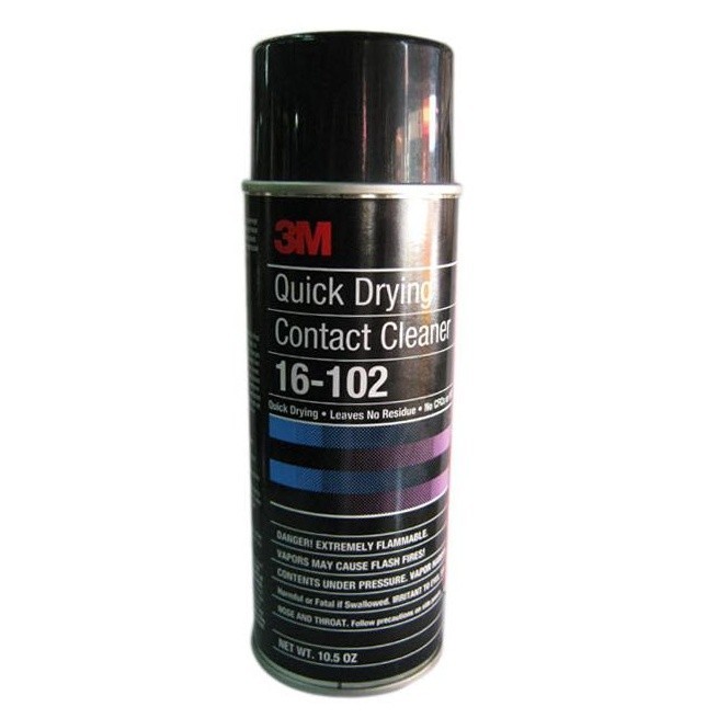

                      Sometimes it's not the sensor (despite diagnostics saying it is) but the plug and/or wiring attached to it.
                      Happened to mine few years ago and a tin of this stuff helped cured the problem. :thumbs:
