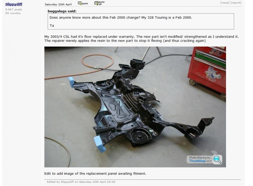

                      unfortunately during the process they have found a subframe crack:bigcry: and mine is past the period of free replacement. So I guess now I need to start a new thread called, has anyone used Redish Automotive for a crack fix? Elms are going to get me a quote on the floor, so i'll see what that comes in at and weigh up the pro's and cons. all part of not driving a boring car and having something interesting.
                        My boot floor is being repaired right now by Munich Legends (at their cost) using the Redish kit. I did try and convince BMW to do the repair but they were unwilling in spite of a couple of emails to Graeme Grieve directly.
                        They charge something in the region of £4K for the repair, an independent such as Redish or Simpson will charge in the region of £1500-£2K and from what I have learned they are much better than the BMW repairs as BMW do no strengthening of the boot floor, they simply replace it and inject the resin (in one side only). There have been cases of BMW repaired cars failing a second time...
                        BTW - I have been told that it is not a good idea to have the resin injected into the floor void as a preventative measure as once done repair is difficult (I was going to say impossible but I doubt that is true), but BMW will not do a repair if the resin has been injected since the resin is flammable....
                              Not true. I'm sure its on a car by car basis and the severity of cracking as to how much work is put in by the BMW repairer.
                              My car received a complete new boot floor and has the welding marks/joint sealer and new paint under the boot carpet to show for it. Specialist Cars of Hitchin completed my repair work and replaced all suspension bushes in the process too :thumbs:
                                Yep, mine had a full floor too . . .
