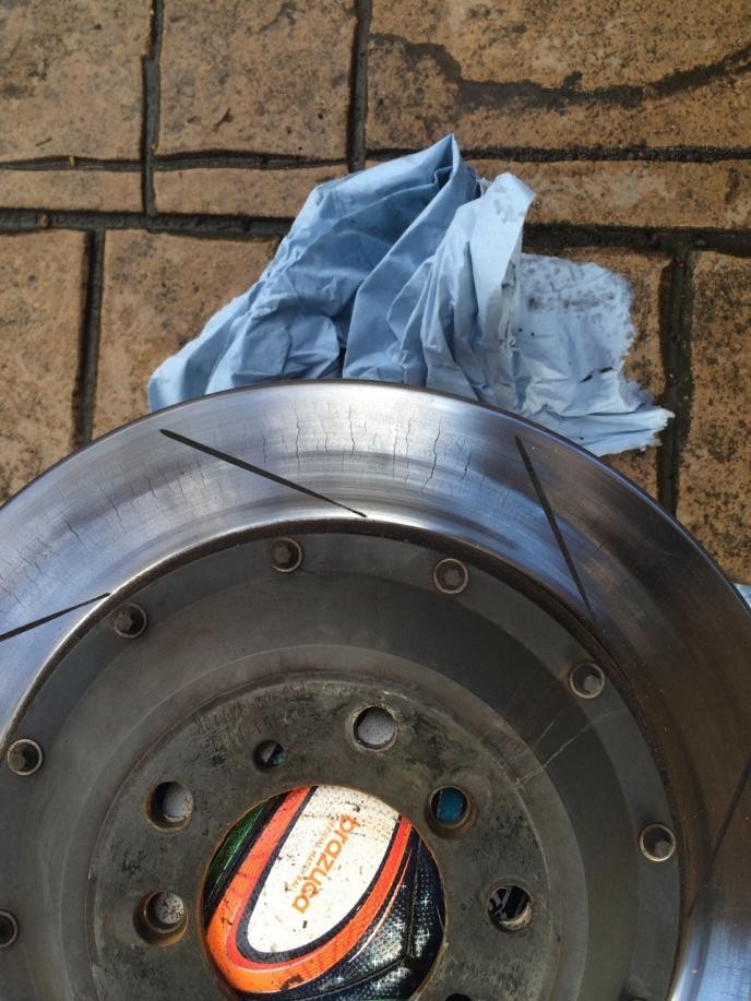

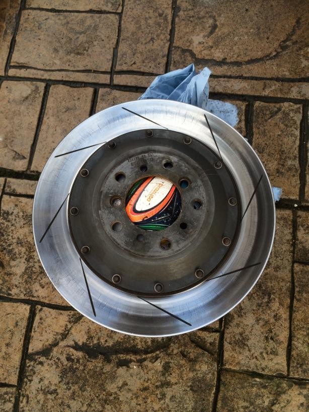

    Evening
    Should I be worried about the condition of front discs or is simply crazing and normal? Thought about having them skimmed to see if it gets rid of the fine lines.
    This is worn out
      Haha hard to photograph but mine have loads of very small cracks running through them.
        No mate. Mine are worse than yours and I'm not worried. Until they are physical cracks like Shimmy posted then I'm not worried
          My disks are just the same fine to use
            Performance friction discs have loads of what looks like cracks.
            But they will wear till there are no more grooves.
              Thanks for feedback just wanted some peace of mind as brakes and tyres not to be messed with.

                Depend billy on heat cycles and cooling temps, I've had some sets of PF dmcrack before the grooves go.
                Make sure you keep an eye on the inside disc and feel for a slight brake click which can be the pad travelling across any small crack
