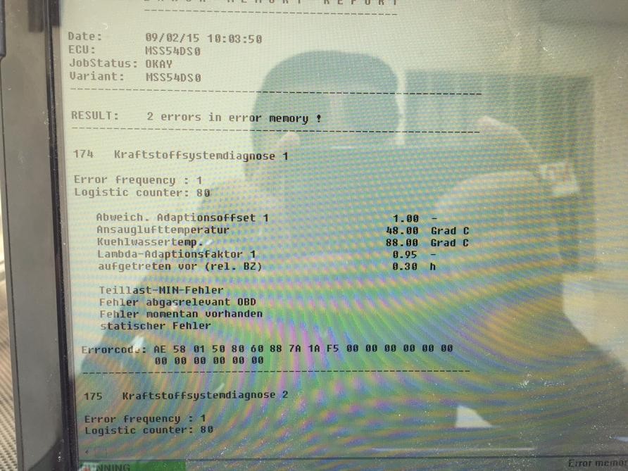

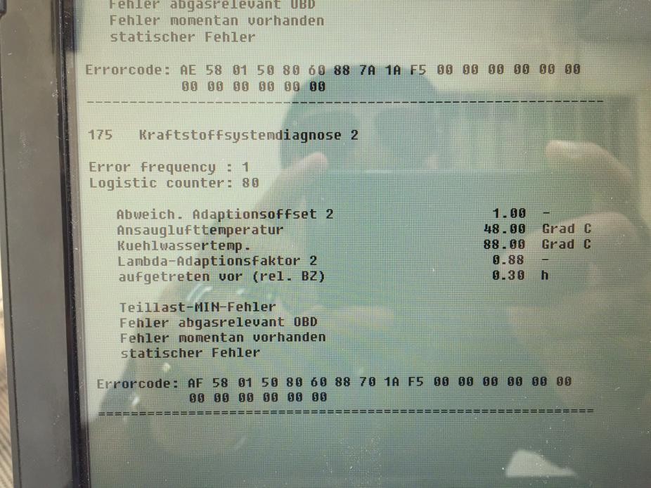

            Ok, So my cars going batshit crazy.... Here are the fault codes from the CEL after replacing MAP and IAT sensors and re-soldering all wires with no breaks in between....
              Not too sure about those codes . Any translation ?
                Fuel System Diagnosis 1 and 2 errors
                below the temp readings and adaptation readings it says:
                partial load - MIN error
                Error exhaust relevant OBD
                Error currently available
                static error
