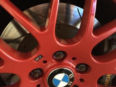

    On mine the pf lasted 6 track days and started cracking. Simpsons told me to try the ap which they said was new. Not j hook. So far no crack lines at all after 4 track days. J hooks are very good but I dun know if they make them for 5575 calipers.
    So no more Pf for me
      AP disc pic
