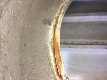

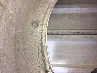

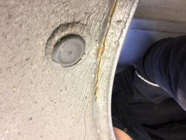

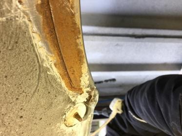

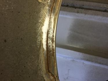

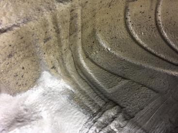

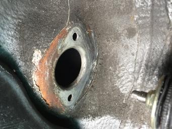

        Only for the not to squeamish :banghead: ..Rear wheel arches, if you fancy taking a close look at your arches before they bite you in the arse... only looks like the slightest bit of paintwork/ underseal cracking, so fook it cut some back ,,, Could be worse :whistle: starts off pic1. clean it up, Treat it to some rust killer prep for zink paint primer :smokin: I can only imagine bmw are glad to see the back of th e46 m3 paint warranty.��
          #34
          Hopefully tinworm poison will do the job. Or at least slow it down :thumbs:

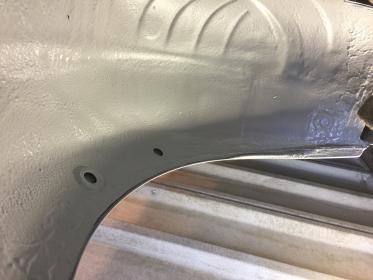

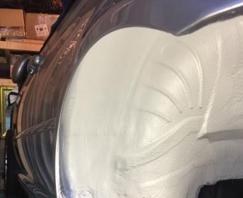

            Almost done, prepping done ready for final colour, as near oem as I can do, Used seam seal and bmw underseal ,:smokin:

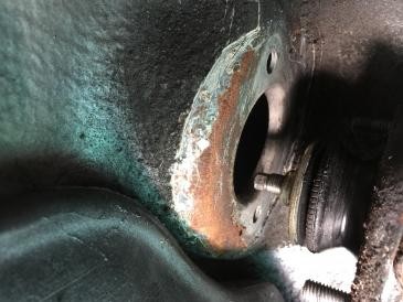

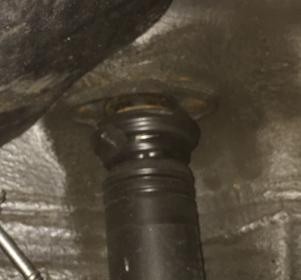

                  No sure if it will stay this shade of grey, but anybody that’s had a new boot floor won’t have original factory underseal finish anyway, but al least it’s covered now and looks tidy, get my new discs and back disc covers fitted won’t look to bad ,waxoil and refit bungs ,and a clear coat.. :smt055. If anybody knows original colour code for underseal, be better to do in in that,,,??? Original underseal colour in bottom pic..
                    #39
                    Hopefully be ok for a few more years , clear coated.. waxoil in arch cavity, plugs back in and sealed , repainted shock dampers while they were off ,, will see how colour fades with time, :smokin:

                          Where to stop, may as we’ll carry on with colour scheme :whistle: lighter colour under arch protection doesn’t show. So not a problem for me . I think original colour is kinda olive green, if anybody can confirm ??
                            #43
                            Chad, very nice work. Are you doing all this without a lift? I believe you are right about the colour of the factory protection.
                              #44
                              Hi Julian, not got a lift but I’ve have these steps, next to garage I use to do the hard to get to stuff, only thing you have to turn car round to do front end :smokin: ..is there a code for the olive colour underseal finish ?? I’m thinking about dropping subframe and repainting, and all other bits and bobs , personally not into plastic coating things, as you can see what’s going on with paint, ok it’s not to everyone’s taste as far as original colour for the purists, and if I ever wanted to sell , but I’m happy with it ..
