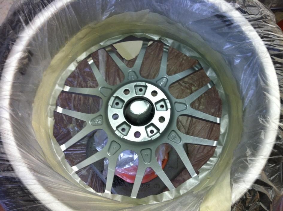

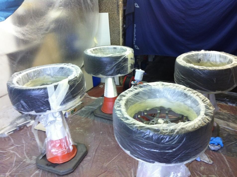

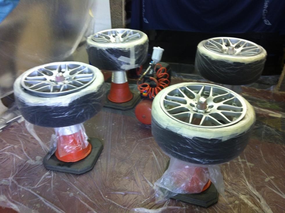

                  Wheels are off and in the process of painting
                  They were all washed and any tar removed
                  Then down to get the bead at the front pushed back so i can paint into the bead :thumbs:
                  I then filled the scratches and little stone chips then sanded with wet and dry 800grit
                  After that a grey scotchpad was rubbed all over the wheel into ever spoke and corner then it was time to mask the wheel inside and the tyre
                  Tomorrow they will get a panel wipe and a tack rag before the silver base coat is applied more pictures tomorrow

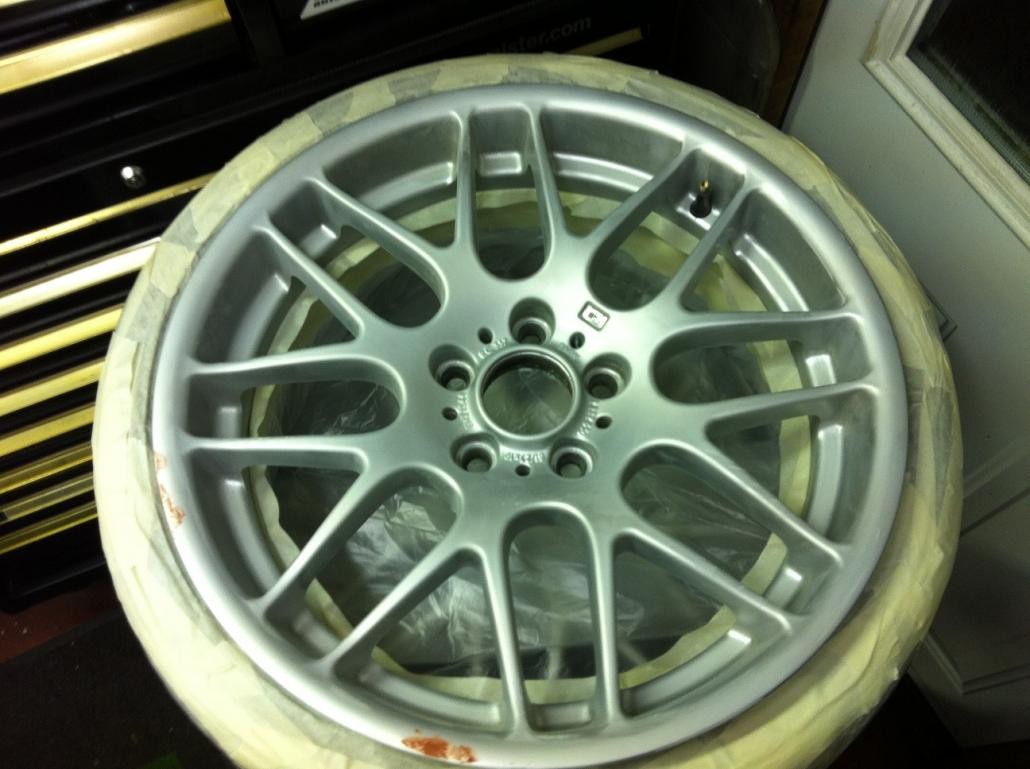

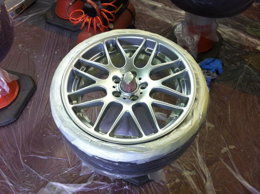

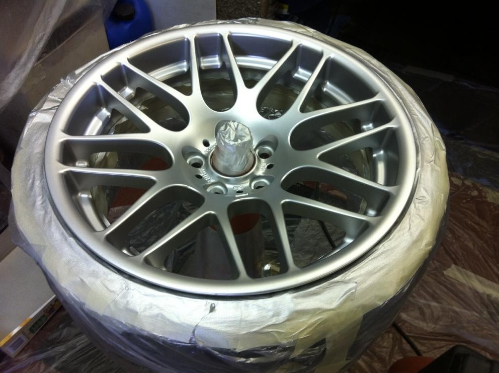

                      Stage 2 base coat
                      The wheels were all panel wiped ready for the base coat i used a silver
                      so i would not need as much sparkling glass as it is thin and would use a lot to cover any scratches :thumbs:
                      I have also done the rear of the spokes.
                      The next stage is the sparkling glass coat more pixs when this coat is on :thumbs:
