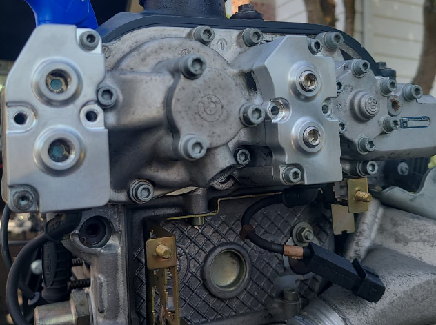

    Hey everyone, I would like to share an improvement that I have designed and now manufacture for the euro S50B30, S50B32 engines. My revision stems from original design appearance (S62), those who know me...know that I am obsessed with keeping everything as oem appearance, even if it needs an upgrade.
    Below is an example of an installed set, exhaust side has the m12 SS set-screws removed.

    The Vanos hydraulic system on these engines see upwards of 100Bar at idle, as the solenoids activate and let the oil flow through them at that pressure, the solenoids themselves dislodge and move within a few millimetres of axial play that is allowed by the factory covers.
    The factory covers also have a thin dust gasket between the cover and vanos assembly which add more room for axial play.

    On the early production S62 engine this problem occurred on a larger scale and it was addressed with a revised solenoid cover design featuring m12 set-screws to preload the solenoids into position, preventing movement.

    Covers will include SS m12 set-screws, the cover threads will fit the oem S62 set-screws if you want to go that route.
