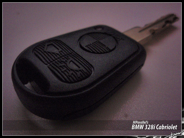

        Nice. So this means you also installed another rearview mirror as the remote controle electronics for the factory system is inside the rearview mirror.
        Which means you must have used an 8 series mirror, which has this and with the for US correct 315MHZ frequency.

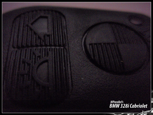

        The keyfob posted there is from an early e46 or e38 model as it has the trunk pop symbol.
        The E36 version of this key has a lightbulb symbol that remotely turns on the interior lights. This also deleted the function to do this by pulling the driver's doro handle.

          I had an E31 mirror from when I bought my Interlagos M3 (the original owner put it in because the oval mirror went bad). I disassembled the E31 mirror and removed the remote control module. I had originally planned on putting it in a plastic enclosure behind the glovebox, but it quit working on me. Not sure if I damaged it or not.
          I found a cheap 2001 Z3 mirror on eBay that had a remote control module inside of it and decided to just use that mirror in my E36 and run the wiring to it.
          The key I used is a Chinese replica since I can't buy uncut keys from BMW. No one makes a key with the light symbol. I had to settle with one with a trunk button. The light symbol on your key is for 433MHz systems. The US 315MHz system light buttons look like a wave.
          That button does work and it does turn on the interior lights for me.

            Yes, the US got the wavy symbol. That's because for it's for the panic alarm function. These are sound waves. And also turns on the lights. Longpress vs shortpress.
            In EU we didn't get the panic function, it hardware disabled. Don't ask me why, hence the light symbol button.
