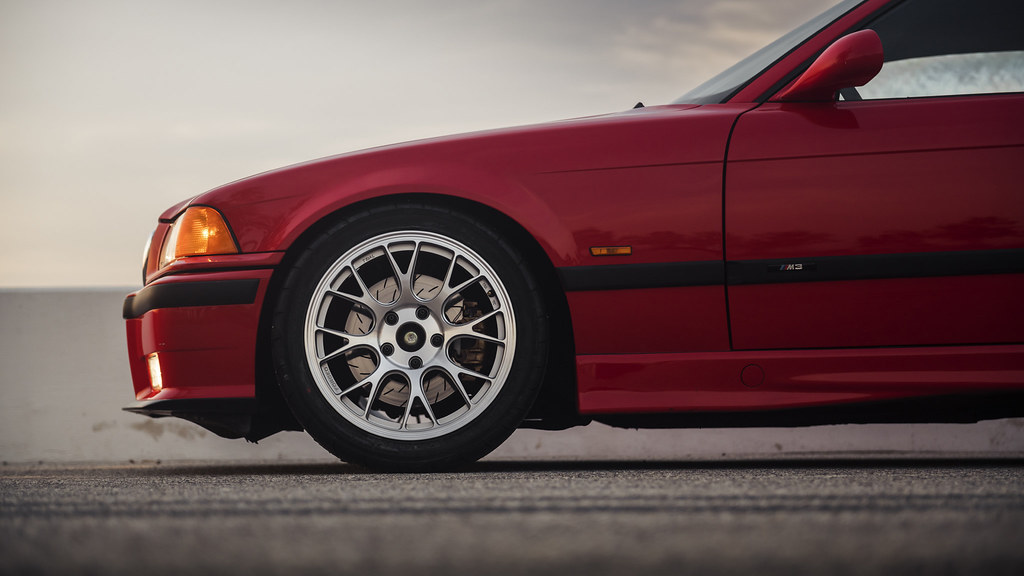

      Nate, there's nothing hooptie about this car. Unless you're great at photoshopping haha. Always been a fan of red M3's and this one is no different.

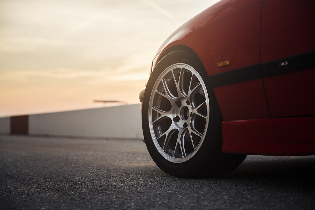

      That's the Bimmerworld wheels right? Got any more shots? These look pretty enticing.
        #93
        Thanks guys, I definitely use Photoshop nearly every day of my life! But not for cleaning up this car. That's just is an iPhone photo with a quick 5 minute color edit since I can't leave well enough alone, lol. But anyhow, yes these are the BimmerWorld TE:AL TA16 wheels. Very good option for a forged 17 for our chassis. Here are some shots from when I first got them on the car last spring. Mine are the 17x8.5 ET40 with 12mm spacers front and rear. Rear fenders are trimmed, -3.5 camber front and -2.5 rear, corner balanced.
