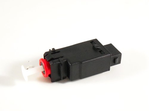

              Here is what the switch looks like:
              Notice the red collar (might be white on some brands). To install or remove the switch, you have slide that locking collar forward, so that the side clips are free to move.
              You want the switch to look like this:
              If you still can't get the switch out, after moving the collar seemingly as far forward as it will go, press the brake pedal down, and slide the collar even further.
              You'll hear a clicking sound, as the white plunger tip on the switch extends. The switch plunger length is adjustable, that's what the clicking is.
              Install can be a ***** too, the connector portion of the switch is quite sharp. Slide the collar forward just like when removing, press the brake pedal down
              (or wedge a stick between the pedal and seat), and press the switch into the bracket, noting the correct orientation. Slide the collar down to lock the switch in place.
              Release the brake pedal, and make sure the pedal makes contact with the switch.
                It is very easy to remove the switch without breaking it. Pull the white plunger as far as it will go, pull the red collar as far as it will go. It will now easily pop out. If it doesn't you didn't pull as far as you they can go.
