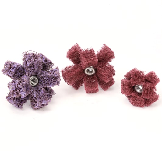

    Fairly common. I use small scotch pad balls for drills to clean mine up. Machine shops will use a fine grit flap wheel.
      Thank you. At $450 per tray I was hoping a new tray was not required.
        As long as you knock down any peaks that might score the cam bearing journals, it’s fine. Unremovable valleys don’t fuss over.
