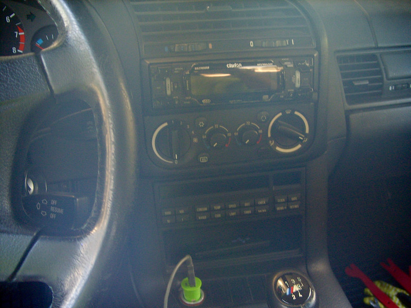

      Thank you M_Parallel for responding...yes, I have the analog system as the photo below shows or unless there was a digital version that kept the analog appearance...that's why I had bought the the version with the electronic mixture wheel. Also, I should have also mentioned that I had replaced the water control valve before using DIS (I didn't have it then) and it seems to make it worst.
      I agree with you that hot/cold dial appears to be not grounded...that's why I am leaning to a wire might be disconnected.
