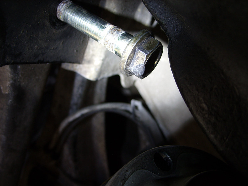

          Then, some torx bolts on the driver side are so stuck they stripped...at least two and those suckers are expensive...$13.21 a pop...wow! What are the methods you guys used get them out? I am not sure a vice-grip would do the job.
            Angle grinder...cut the heads off then use vice grips to get the remaining part of the bolt out once the half shaft is removed.
              You can hammer a torx socket on. Don’t do the initial loosen with an impact. Do by hand first then use a tool to spin off. Also make sure you use the right size torx. You might have stripped because you were one size off. If you can’t hammer the torx on, then cut the head off with a grinder or Drexel. Once you have the axles out there will be enough strip left to vise grip out and chances are it will come out.
                You probably used the wrong size torx socket. The bolt heads need to be clean and the torx socket needs to be tight and fully seated on the head. The right size takes a little effort to fully seat. The wrong size up goes on too easily.
                  As for replacement cost, shop around. Beware M3 bolts are a little longer than non M3 bolts do get the right length. One person used hex socket head bolts as a replacement. I don’t think there is anything wrong with that other than that the socket head actually strips more easily than the torx head.

                    Well, I had used the correct size and used a 3/8drive breaker bar with a 11/2 extension attached to avoid the axle boot and may have had a lean...meaning the socket wasn't flat on the torx bolt which mess up the bolt head. Then, when I go to take the bolt off, the socket would fit; so, I thought I might have picked up the wrong socket. I then picked the next socket size only to realize it's the 14mn. It may turn out that it's only one that really bad...I'll see later.

                          Since those two toxr bolt will take an act of congress to remove, I decided to apply a government response by kicking the can down the road. The drive side wasn't leaking...only the passenger side that didn't present any problems removing. I had also hoped that remove the output flange would allow complete removal of the upper bolt of the lower rear control arm as I am replacing with adjustable ones. Here are pics of the two frozen torx bolt and my attempt at the upper bolt on the rear lower control arm.
