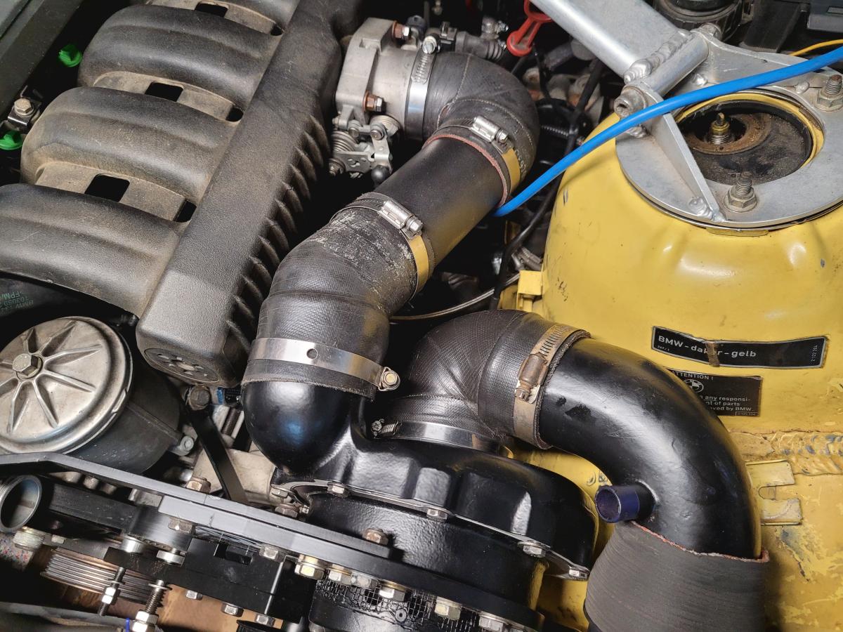

    Just completed a Hybrid Dinan Powerdyne Supercharger install. Currently non intercooled but I have a front mount one to install as my next step project. It's running about 95% now. Ran it on Road Atlanta for a weekend and it did well. Then dyno on a dynojet 2 weeks ago and came back with 260 rwhp. Very consistent 3 runs back to back. 259.3, 259.6 then 260. There is more tuning to be done and I have a too rich idle issue to resolve but I am happy with the results for now. I wanted to be sure it doesn't run lean so it's running slightly richer.
