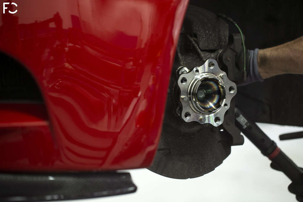

                      Thanks for sharing! We have been offering the F8x hub retrofit kit for E9x M3 and E82 1M, but addressing the brakes is one of the car's only shortcomings in stock form.

                        I have the future classic f8x hub conversion for the front axle of my track e90, it's a great upgrade! Good job IND!
                          F8X bearings would be stronger I'd imagine? Might also solve screw-in wheel stud snapping issues by running M14 studs instead. I don't really notice F8X owners posting about their M14 studs snapping, but seems like a lot of E9X people experience that.
                            Core 4 now offers F8X hubs with 14mm press-in studs for E9X cars:
                            Interested in #f82m4 #f80m3 front hubs converted to 14mm press-in studs for your #e90m3 #e92m3? NOW AVAILABLE. Not only #f8x front hubs, but complete sets with everything needed to bolt onto your...
                            Probably as bulletproof as you can get...
                              The F80 front hubs save a little weight also, they are a good looking piece.
                              I wouldn't say a lot of people experience stud failure, the failures were on heavily tracked cars, so it is a good upgrade for those type. The rears are harder change, so unless you do all 4 corners, you'll be running M14 on front and M12 on the rear. You'll have to babysit every shop that has to take your wheels off, otherwise there is a pretty good chance they mess it up.
