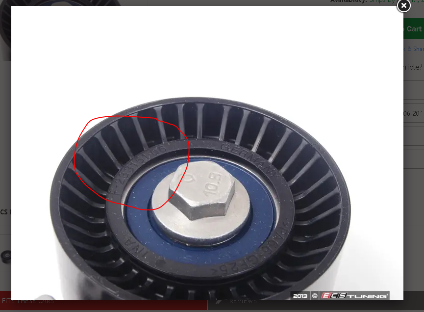

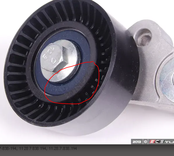

          Quick question, from all the research that i did, it pointed out that the AC pulley was the same part number as the water pump pulley, I essentially ordered two of the same. Even looking at photos from BMW showed that it was the same pulley part number for both. Could i ask how did you come up with 5320557100? Do you know for a fact if its an interexchangable part or if it wont fit? Trying to determine if i should order 5320557100 right now.

            They are all the same pulley part number, the two on the left are the pulleys pulled out of the car (original bmw) - The one on the right is the fcpeuro replacement for PS/AC - Confirmed they are all the same pulley.
            Just to clarify this is for an early production 2008 car, before 04/29/08 - Hope this helps anyone!

                      Im not sure if that is true, i measured both pulleys and they are the same in diameter. Also, they are the same part number, you can see it in the photo above. Im not sure if that applies to the lci or post 04/29/08 cars but at least on mine it was the same. Car only has 50k miles so this is the first time doing the pulleys.

                          Sorry but thats not the case, i have owned the car since basically new and i barely drive it. With 120k miles on the clock, isnt it possible that your pulleys got replaced multiple times?
                          Additionally, the base of my research is as follows:
                          pulley part number from bmw AC/PS:
                          pulley part number from bmw WP/ALT:
                          All pulleys lined up, far right is the replacement:
                          As you can see all the part numbers match.
                          So unless BMW ran out of the 70mm diameter pulley, im not sure what else to say :-/ - In any event, we are going round in circles here, i think its best for people to order 3 pulleys to avoid downtime and compare them before installing them. Or if you have the cash just order the replacement tensioners that come with the pulley from BMW.
                          Best,
                          Irhase46m3
