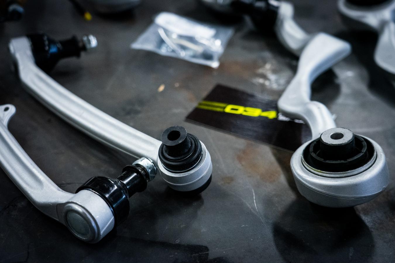

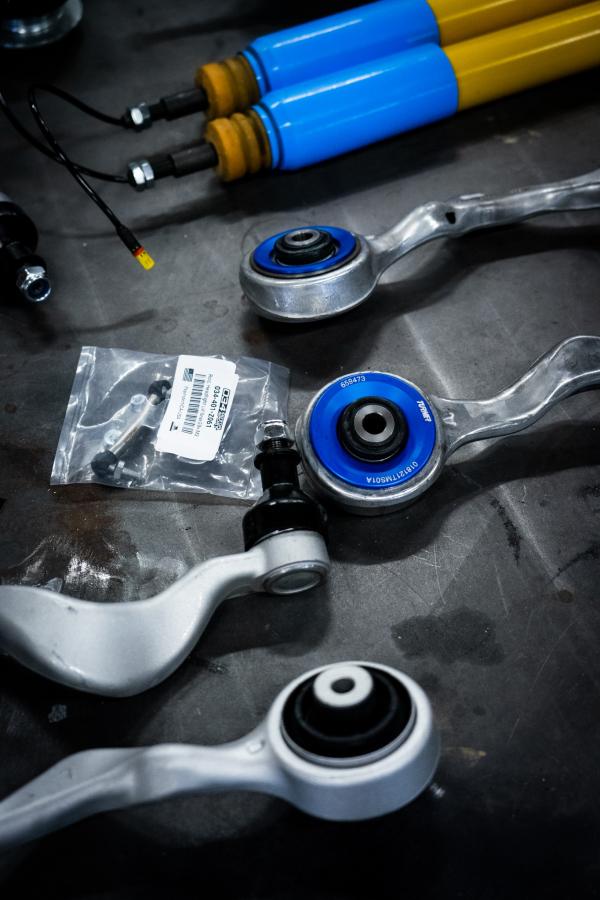

        What Tbonem3 said is true, the options to upgrade the E9X M3 suspension quickly cross over into track-only territory as most arms sold by SPL, Turner and others are unsealed monoballs and require higher upkeep, and introduce more noise.
        I uprated my front end for street use using really the 2x only proven options that are durable for street use: the sealed monoball upper control arms from Turner and 034 Motorsport lower control arms with uprated rubber bushings. Unfortunately they sell that as a kit with their uprated rubber bushing upper control arms.
        I have upper control arms with monoballs on the E9X M3 and also just fitted a set on my E60 M5. It's a must have IMO. The front end of these cars can get wobbly under load during acceleration and breaking. Street bumps also deflect their OEM bushings quite a bit and make the front end feel mushy at times.
        They add little NVH, are a bit harsher over bumps and cracks, and you can feel them in the steering under cornering loads - that's actually something I like. It reminds you you're driving something special.
