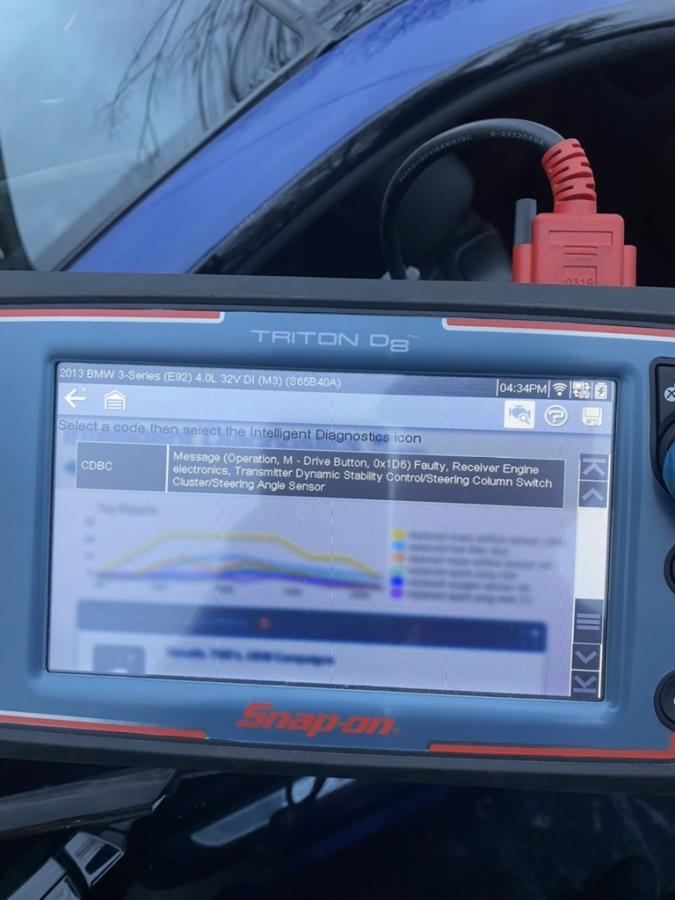

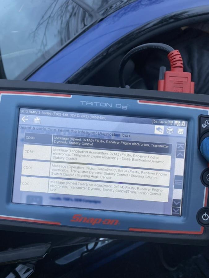

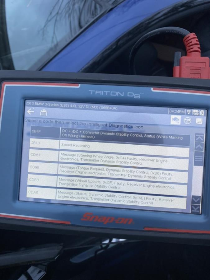

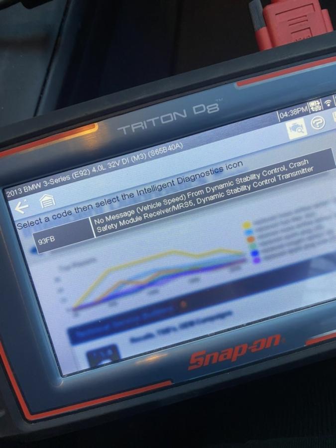

    I have a 2013 M3 DCT. When I'm driving, the radio will sometimes go out, I hear the BMW chime then every single warning light comes on the dash. Abs, traction control, check engine, air bag, and a few other misc ones. The wipers come on and the redline raises to 6k. Then after a few minutes, everything goes off and it returns to normal. All the lights will go away except for the airbag light. The airbag light stays on until I turn the car off and turn it back on.
    I scanned the codes for this car and this is what came up.
    Any ideas on where to start?
