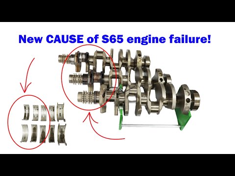

    Interesting tear down and discussion on S65 main bearings and the potential for failure from Brintech. Nicely done and straight to the point.
    I have heard this theory about the timing chain pulling the crank enough to wear out the first main bearing. I would think that some upper bearing wear should also be happening to bearings two and three since the entire crank is being pulled at one angle. All I know is replacing main bearings on the S65 is an engine out service due to the use of a bedplate. I thought that you could roll the main bearings in, which is possible on an engine with main caps.

      I still have questions, and they're pretty much the same questions I have every time a couple of guys talk like they've used garage tools and moxy to outperform one of the most competent and best-equipped engine builders in the world.
      What percentage of S65s actually have this issue? There are tens of thousands of these engines all over the world, and they've been doing real miles for years. With numbers like that, there's always gonna be a story every once in a while where some shop somewhere happens to have several engines come in in quick succession with the same failure mode. It's bound to happen by chance alone, even if you ignore the fact that shops like this are disproportionately likely to see catastrophic failures. And now that shops can post about this stuff on platforms like YouTube, whose algorithms will make sure we see it, we're likely to hear about it. Maybe it's indicative of a trend with this engine, or maybe it's a fluke. There's no way to know just from one shop saying they've seen five engines like this and a smattering of other anecdotes.
      What are the histories of the engines that have had this issue? They're talking about this like it threatens all S65s, but do we know for sure it isn't affected or determined by usage patterns, fuel, etc.? Sounds like they either don't know or don't want to share.
      Even if we buy the idea that the no. 1 main is worth worrying about like the OG rod bearings were, how do we know the best fix is to mess with the bearing, never mind boring out that hole in the block and adding a sleeve? Do we know for sure that fixes the problem? Do we know for sure the process has no side effects? Looks like Brintech doesn't. All they say is "it's working well", which is vague enough to be almost meaningless. And that part about the oil hole mod, where the guy basically says he's pretty sure it'll be okay... Woof.
      I guess I can't speak for everyone, but I need a much higher standard of evidence before I let someone disassemble and cut on my engine.
      I'll be watching this space, especially because the stakes seem high if Brintech is right about this. For now, I don't buy any of it.

        There are a few examples with this main bearing failure. Even if it is or is not a thing, you just have to run the engine as long as it will go. All you can do is warm up properly and change the oil. If the engine lets go, BMW made about 66,000 of them, so there will donor engine somewhere.
        Knowing that the main bearings can go, it almost makes you not want to do the rod bearings lol. Speed Academy did the rod bearings on a higher mileage S65 only to have a main bearing failure less than 4000 miles later.

            I just bought an S65 that was locked up. I assumed it had a spun main, but has a spun rod bearing instead. I pulled the oil pump and can see the #1 main has not turned. I'll have it a part to address the crank/rod and will be curious to see the condition of the #1 main bearings.
            I agree that this IS an issue, but I also think that it is still so small in quantity that its hard to justify worrying about for the vast majority of owners if they are treating the engines properly.
