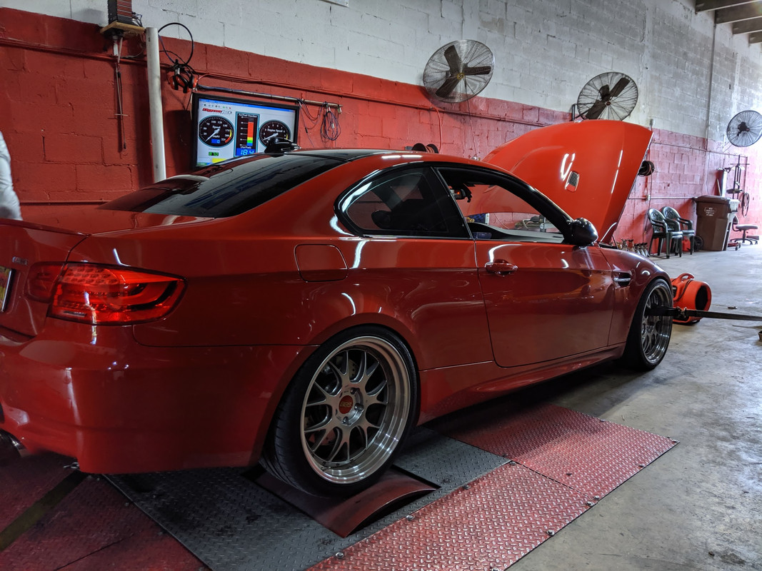

    I couldn't wait any longer, I want to install the headers, so I went and got the before dyno today.

    Results are not great (peak number wise), but it is 93F Heat & 40% Humidity
    STD: 344rwhp 251rwtq
    SAE: 336rwhp 245rwtq

      DYNO RESULTS ARE IN!!
      I am happy to say these headers made power over the entire range and sound great in my opinion, it adds raw engine sounds and more motor noises without being insanely loud like a few setups I've heard. My goal is to have a Eisennman Race to replace the CNT racing one day:
      +15whp / +8wtq in hotter conditions 96F vs 93F, same 40% humidity

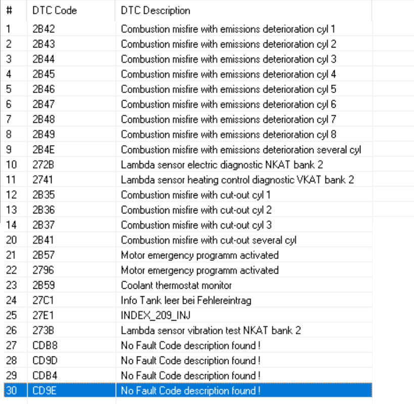

                  Your issue sounds exactly like mine, exact same issue since I switched to full decat ( no more primary, no more secondary ), 8 new ngk plugs, 8 new injectors, 8 new coils, all genuine bmw parts.
