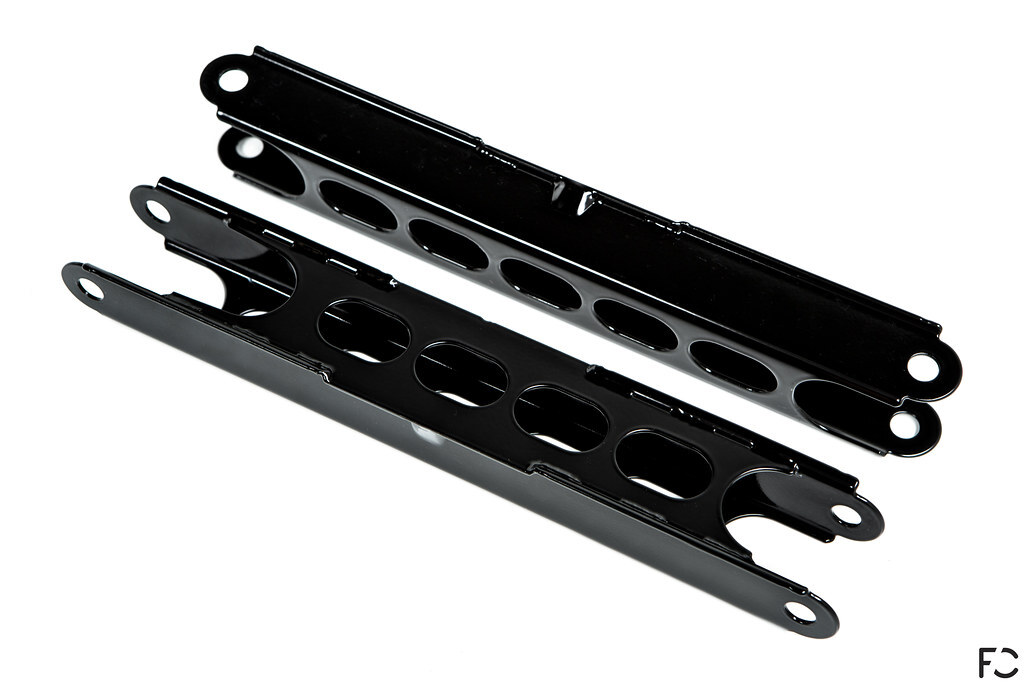

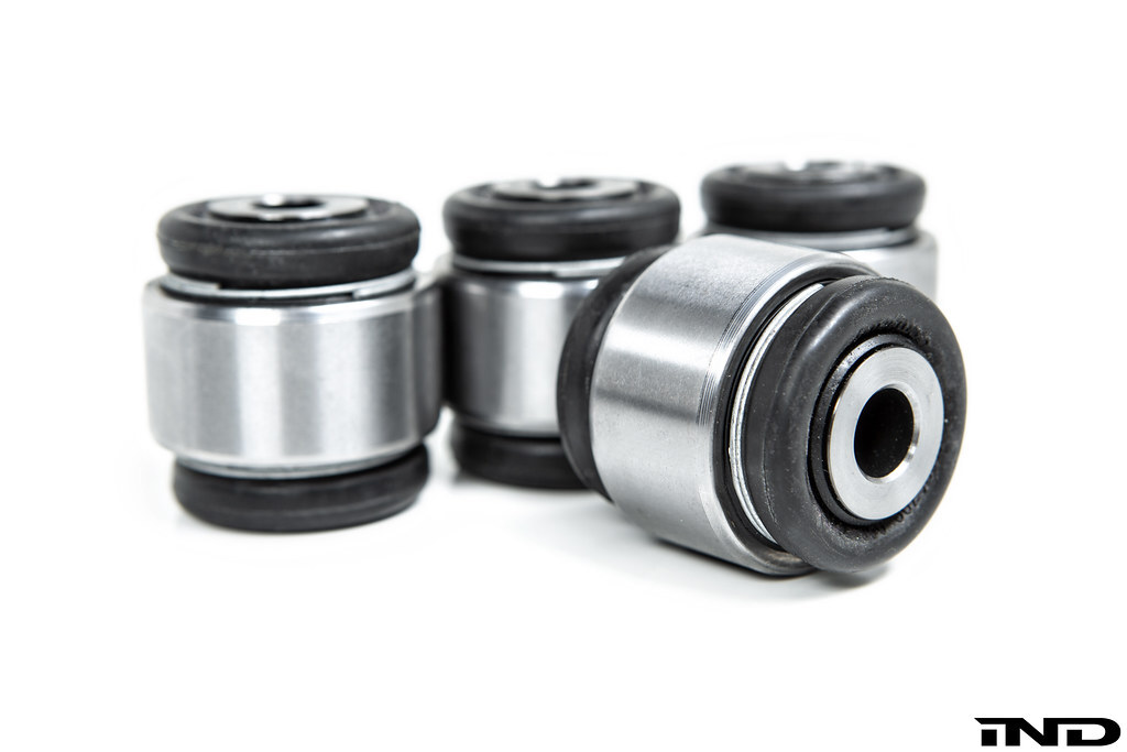

                            For the back, we are big fans of our Future Classic Teflon-lined spherical RTABs. You get the elimination of unwanted flex and far more precise suspension tuning while rubber dust boots on the outside keep debris out and the grease in. There is no increase to NVH. We also offer reinforced trailing arms if you're not going adjustable or can't due to class restrictions.
                            Click image for larger versionName:	49352328513_b0d8aef5f1_b.jpgViews:	0Size:	63.5 KBID:	35801
                            Click image for larger versionName:	48674138342_d6cb28b4ab_b.jpgViews:	0Size:	78.6 KBID:	35802
