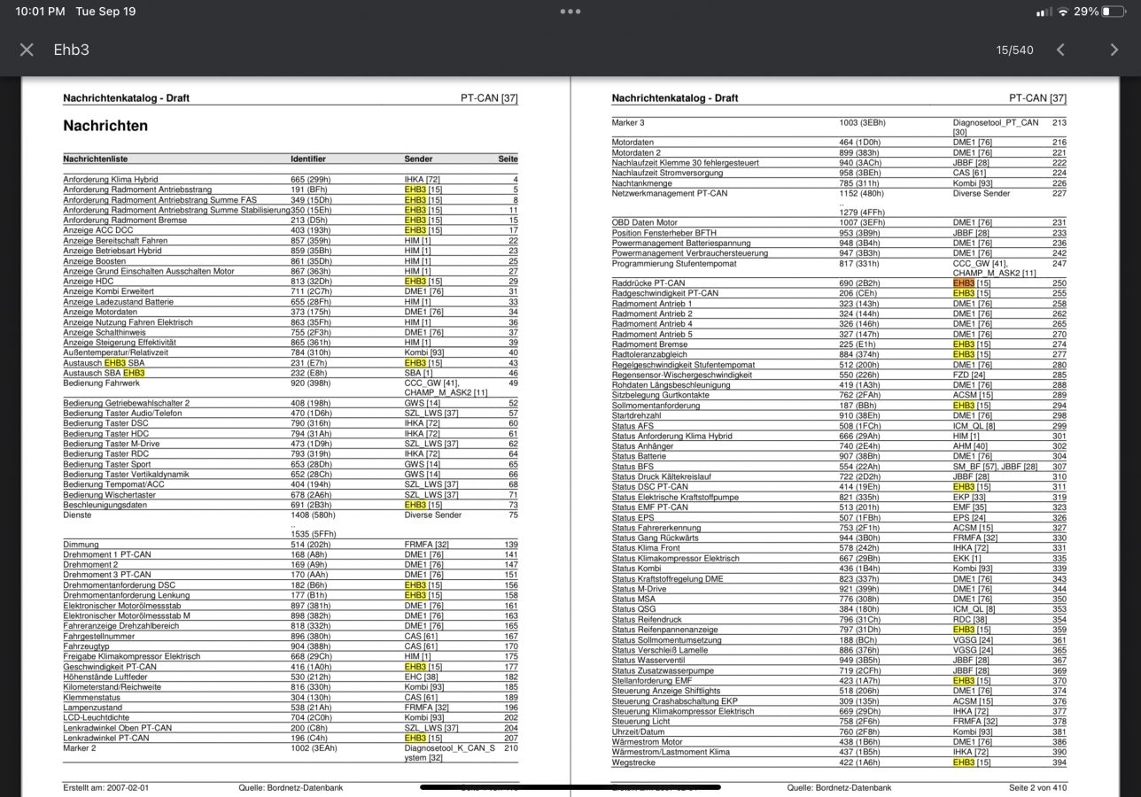

      It’s a fairly significant amount of information, but this should be of use. DSC module is called EHB3 and you can see the CAN message listing here.
        #33

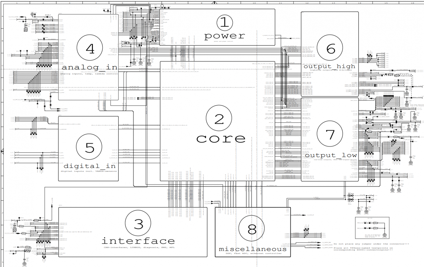

        Might be of interest for MSS60 and MSS65 hardware comparision.
          #34
          Hello,
          I am working on putting together a DBC file documenting BN2000 messages as part of my project here: https://github.com/superwofy/E9X-M-C...gration-Module
          I've already documented quite a few BN2010 messages for anyone to use and have a partial BN2000 dbc but it needs more work.
          Is there any chance you could share this catalog​?
          Kind regards
