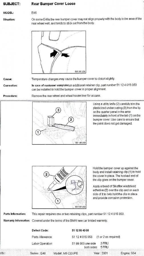

Does anyone have the bmw tsb for the rear bumper sag on e46 m3’s
    The tsb had the part numbers for clips that go on each side. This was posted on m3forum.net but alas that’s long gone .. does anyone have it ? Thanks in advance
    Do you know the number?

        No I didn’t know the tsb number .. thanks man .. I think there was one specific for e46 m3 but maybe it’s universal im gonna run the part number on google to see .. thanks again
          I found a 27 page on it on this forum from 2020 that has all the info. The clips are diff depending on if you have pre or post lci
            Link here in case someone comes here instead.
            That part number appears to be sedan only.
              I posted about this on this forum. A few others like Royalflushness and Nextel (Shawn) posted as well.
              This won't fix bumper sage though, it'll just make the bumper edge (forward) flush with the fender.
                Could you post the link to this thread? I know of this thread but can not find it myself.
