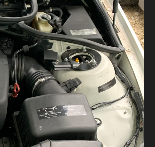

    Most certainly not. As installed, he can only loosen the 3 nuts and get caster adjustment (but it's not actually caster adjustment - it's supposed to be camber). That makes no sense. It really makes no sense when you ponder how he's supposed to adjust camber as they're installed presently. You can't even access the 4th cap bolt (hidden or do they only include 3 lol) so how are you going to loosen the assembly to adjust camber, if this installation is correct? Again, makes no sense.

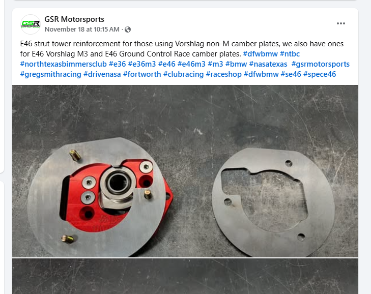

    Here are more photos of correct plate installation. Again, the inner slotted area is for caster - they always have a screw with allen key head and that action is front to back. Camber adjustment is side to side.

        How do you adjust if a bolt or 2 are blocked? (See gc's pic above)
          Same way you would if you're making changes on your plates, just an extra step
            You have to drop the struts down or cut the tower, see my pic above
