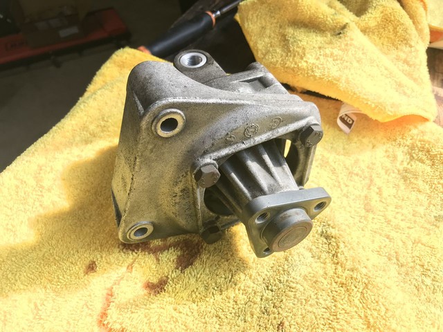

                The E36 M3 pump is definitely different to the E46 M3 power steering pump. It has a longer "neck" compared to the E46 one. Hence the difference in pulley offsets.

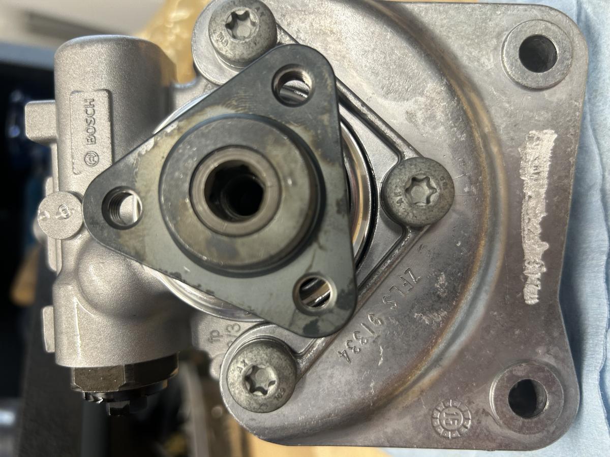

                          FYI to anyone considering buying the Bosch reman part# KS01000623. I just received one of these from RockAuto and it is clearly not a reman ZF pump. There was no ZF logo present in the casting on the front or on the rear cover that bolts on. The rear cover piece was also a darker gray color. All of the external cast pieces are a much rougher casting than the OE pump. There is a Bosch sticker on the back that says made in China. On top of all that it did not include the mounting bracket that is supposed to come with it. I'm returning the pump to RockAuto, and I ordered another from Autohaus AZ this time, in hopes that it is the genuine part.
                          I know Bosch parts are commonly counterfeited, so I can't say for sure if this is a genuine part or counterfeit, or whether Bosch has just changed sources and is no longer actually remanufacturing. In any case, be on the lookout.

                              I just bought a “Remanufactured Power Steering Pump - Bosch ZF 32412229679”
                              ​FCP: https://www.fcpeuro.com/products/bmw...zf-32412229679
                              This is what I received:
