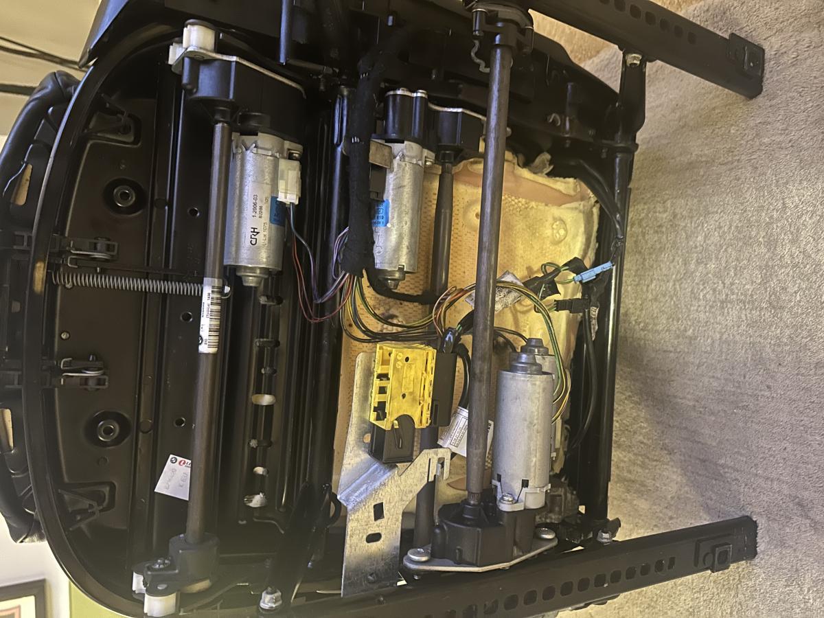

    At the end of 2024 (12/31), I installed a pair of e85 Z4M seats in my e46. For those of you that don’t know, these are a neat plug-and-play option for us that don’t enjoy the stock sofas. The seats look awesome, sit lower and just bolted in, after I swapped the seatbelt receivers over.
    As for the plug-and-play aspect, the seat heaters work and the power controls operate the seat correctly. However, I am not able to use the memory settings to recall saved seat positions.
    Reading the error code yields: “Power supply hall sensor, short to batt+”. Oddly enough, the e46 seat underside seems to differ from these Z4M seats in that the e46 seats have long flat connectors that appear to service the hall sensors, if I was a guessing man.
    NOTE: The red “M” for saving positions does light up and pressing the 1, 2, 3 buttons moves the side mirrors to their saved positions. The seat doesn’t move though.
    Also of note, the driver seat moves when using the controls in 3 second bursts and I swear Memory Position 1 worked the first time I pressed it after install and the motors ran for more than a burst. The passenger seat moves consistently whilst the toggle lever is pressed.
    I have removed the seats and checked closely for broken wires. Nothing. I’ve cleared the error code. It comes right
    back.
    SOLVED: Problem was faulty wiring. Changed the wiring under the seat entirely and normal seat functionality returned.
    Thanks to all who chimed in. You are legends.

    Update: I checked all the connections and wires from start to finish. They look good.
    New Clue #1: The power seat controls require two presses in order to move the seat. Doesn’t matter which direction or function. First press just clicks. Release and press a second time for movement.
    New Clue #2: The seat moves in bursts no which which lever or direction is pressed. Seat back, seat base, tilt. They all move for 2-3 seconds then stop. Double pressing the switch moves them again. This tells me it’s something central. Perhaps the switch panel itself?
    Feels like these two clues might get this moving, no pun intended. Any thoughts or suggestions?
      To be clear, other folks have successfully swapped in these seats and they work fine or are you the first to do it and coming up with this memory issue?
        It honest. Sounds like the seat control module is bad. And maybe worth your time just to swap out the seat module with one from your old seats
          Both E85/6 and E46 have a Control Module 5 (GM5), but the part numbers, current and superseded, appear to be different.

              What year is your car and do you know which year your seats came from? My car is an 04 and the seats came from an 06, I'm told. A photo of the underside of your driver seat would be AWESOME.
                Good call and agreed. The problems suggest one centralized problem--I was zero-ing in on the switch. Not sure if it is the same between the e46 and e85, but it appears to be an easy swap, if so.

                              Update for posterity: the electrical gremlin returned and I had the codes read by something better than PASoft. It showed hall sensor errors at all motors and the memory control unit. I surmised that the problem was systemic (rather than acute), so I changed the wiring harness entirely. I am happy to report that this did the trick.
                              Conclusion: if you are suffering problems similar to mine, check (or in my case, change) the wiring.
