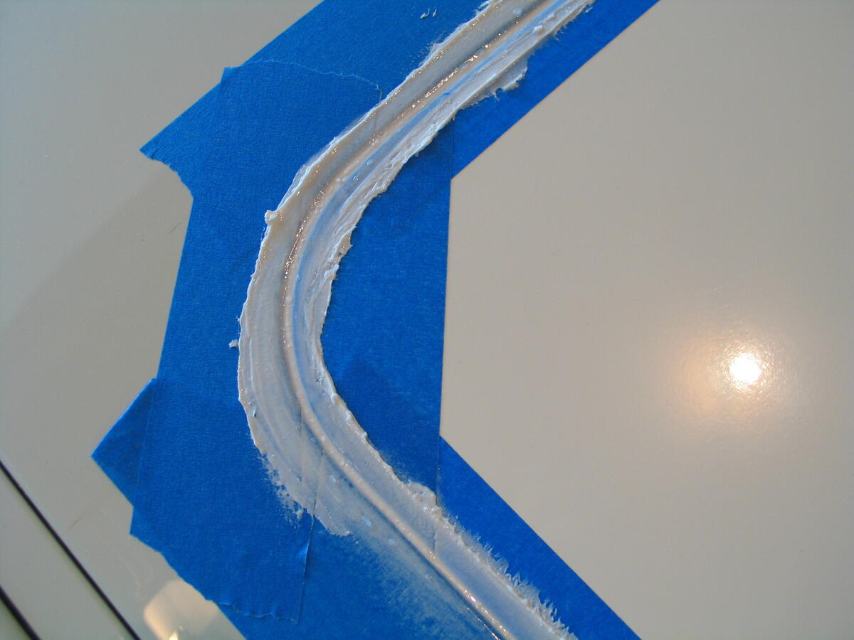

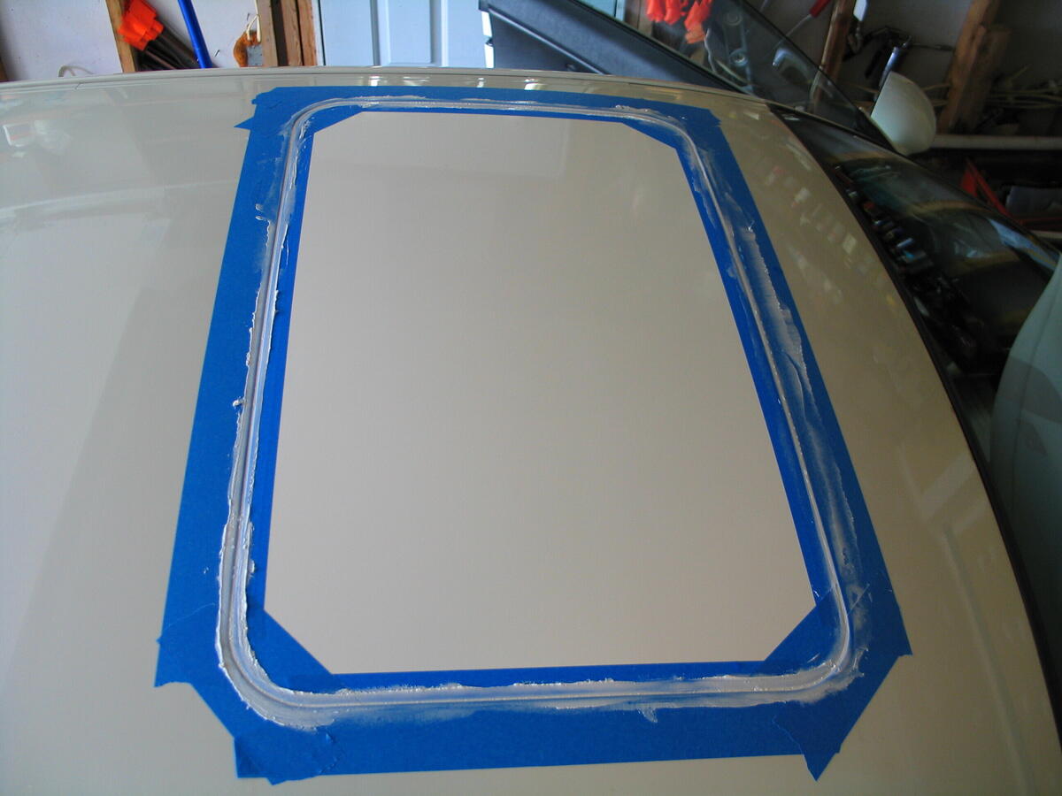

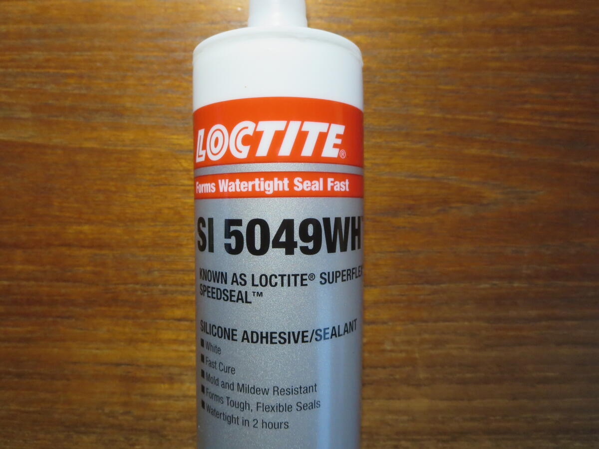

        After considerable research:
        Click image for larger version  Name:	yZc6CC.jpg Views:	0 Size:	99.6 KB ID:	83715
        Click image for larger version  Name:	w6He5e.jpg Views:	0 Size:	86.0 KB ID:	83716
        Then scraped perfectly flat with a credit card to remove any excess and make it conform to the shape.

            S2R CF. Wrapped in matching white vinyl.
