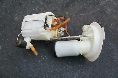

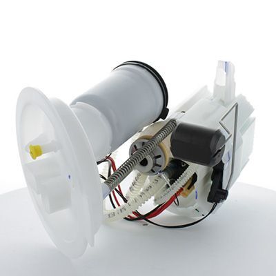

                    f8x has built-in fuel filter (into the fuel pump cover), so fuel pump performance drops a dramatically, when filter goes dirty.
                    we have this issue here in russia a lot more often, due to a worse fuel quality.
                    so, our local f8x guys, who have a lot of track time during season, change fuel pump (which goes with this cover and built-in filter in one cat number) every year.
                    some another, more smart way. if you check in the bmw cat, there are an option, when you have external fuel filter location instead of internal in the cover.
                    so, not to change fuel pump every time, you can make a swap to the external filter config one time, and then change filters only.
                    i've checked it and this external filter widely common and available for many other bmw models in local shops, and cost about 30-40$ per item. so you only need to order and wait one time all this parts, like different fuel pump, some fuel lines (cause external filter locates under the body) etc, and then changing this filter will be easy enough.
                    if i remember correct, all this parts for the swap cost about 1.5-2x of usual fuel pump cost, so not so huge difference, compared to every year change.
                    Click image for larger version  Name:	thumb.jpg Views:	0 Size:	15.0 KB ID:	87899
                    Click image for larger version  Name:	s-l400.jpg Views:	0 Size:	16.9 KB ID:	87900
                    barrel on the cover - built-in filter
