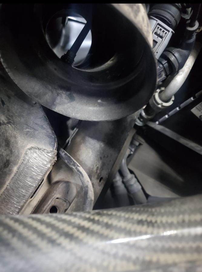

                        TMS CSL Box V2
                        I’ve had this for a few years now and I still think this is one of the better boxes out there, the low grumble and roar at WOT is unmatched and incredibly addictive. I’ve been running an HTE Alpha-N tune (dyno tuned at EAS) and with just headers, box, 200 cell cats (stock section 2 and muffler), I made 335 WHP. I do plan on cams in the coming years, that’s most likely the final piece to the puzzle for me engine/power wise. The tune is great, runs like stock i.e. no idle hunting or hiccups at any RPM and just rips all the way to the top, Hassan took a lot of time tweaking it to get it to this point.

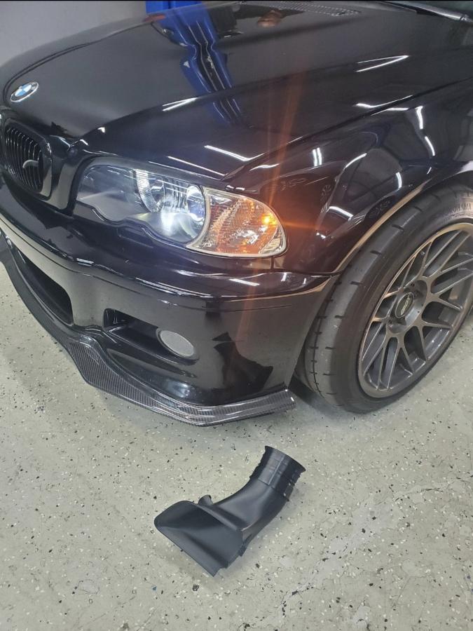

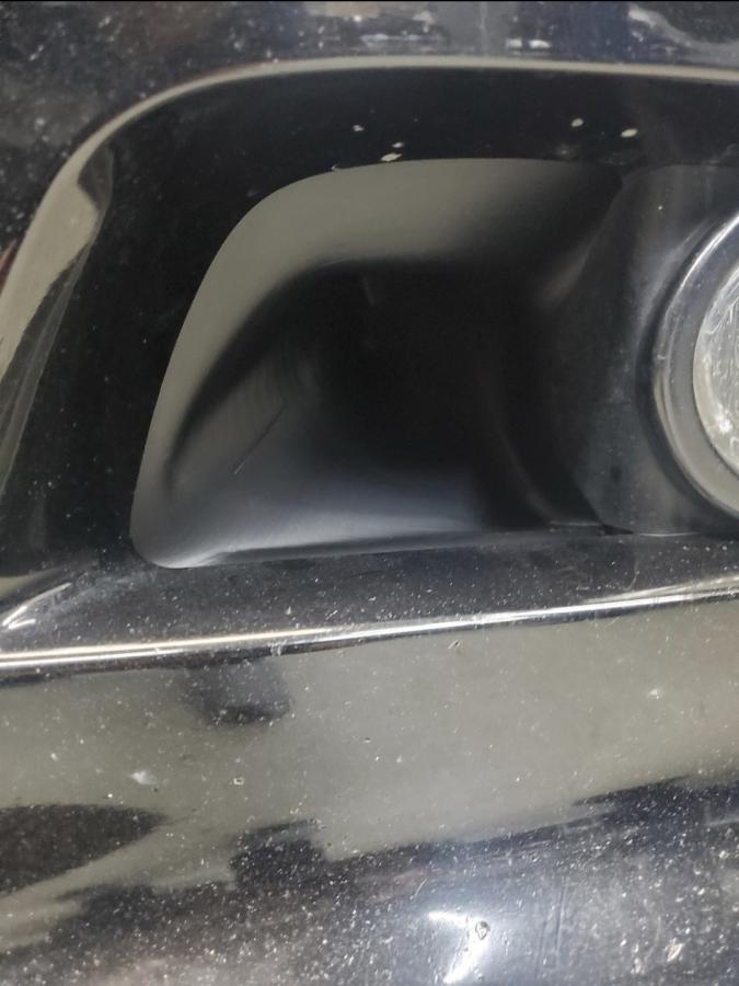

                        I did relocate my IAT to the brake duct per his recommendation and it worked well for me. I just recently replaced the brake duct with Bryson’s custom inlet that Kaiv sells and the change was noticeable from the butt dyno (obviously at speed when air is flowing) and the intake grumble is a little more pronounced so definitely recommended.
                        Click image for larger version  Name:	intake 1.jpg Views:	0 Size:	89.3 KB ID:	326038
                        Click image for larger version  Name:	intake 2.jpg Views:	0 Size:	59.1 KB ID:	326039
                        Click image for larger version  Name:	intake 3.jpg Views:	0 Size:	60.9 KB ID:	326040
                        Click image for larger version  Name:	intake 4.jpg Views:	0 Size:	57.8 KB ID:	326041

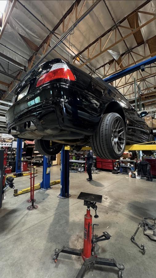

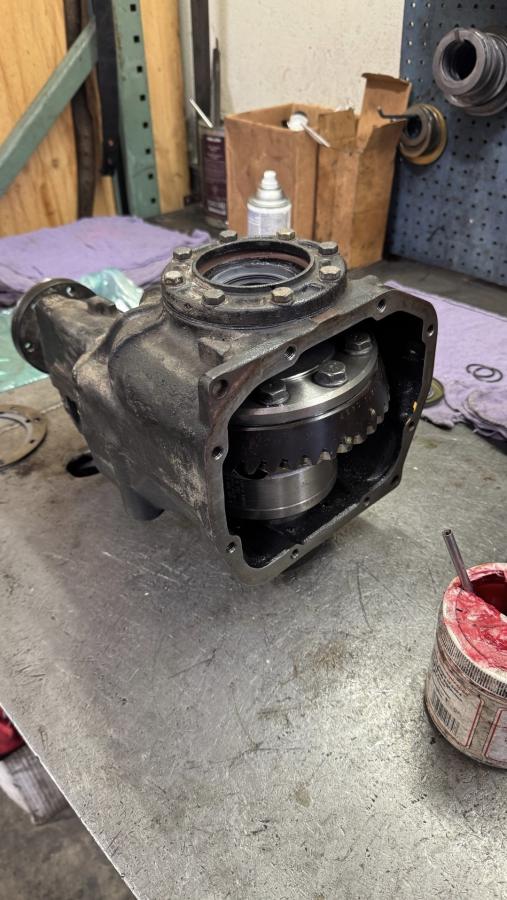

                        3.91 Gearing Change
                        This was a big one for me, I was on the fence for quite a few years on whether to stay stock go 3.91 or try the 3.85. I kept reading as much as I could on every post and forum (even the Z4M forums) on what this change was like and it all came down to this: what was my preference and what was I looking for. Personally, I wanted to get through 3rd gear quicker and get the power down better. A little low end grunt would be an added bonus. Given I drive on the freeway a lot when I do take the car out and toodle around the city, the 3.91 seemed like the way to go. I sourced the ring and pinion and shims from Pedro at peaky parts who is based out of Portugal and had it installed at a local shop called Unitrax here in Corona. Install went well and the entire process was pain free.
                        When I left the shop the day it after it was installed, I was expecting a huge change like 1st gear being unusable and a butt load of torque but the car moved away like nothing had changed, I almost thought they didn’t change anything at all. I got on the freeway and slotted into 6th and noticed my RPM’s were a little bit higher (about 250ish) at cruising speed so it wasn’t annoying and bearable, you get used to it within a couple of drives and forget.
                        A couple of months of driving it and I realized that I actually loved it. The changes are subtle but significant at the same time. I get a lot more power down, I get around the city much easier and 5th gear finally became a gear I use more which, oddly enough, has given me better gas mileage since I have more power in the higher gears so no need to downshift or rev out. 3rd is a riot, when I go WOT at 3k rpm it just throws you back and you see the shift lights flash on (had Hassan flip them on for me, apparently it’s something you can switch on even with a manual car). When I want to drive easily to OC, 6th is nice and I actually have power to move in and out without needing to downshift. My brother took it out as well and the first thing he said was that the differential upgrade is definitely great. All said and done, it suits the nature of the vert and so glad I went down this route, it compliments the other mods incredibly well.
                        Click image for larger version  Name:	diff 1.jpg Views:	0 Size:	89.2 KB ID:	326042
                        Click image for larger version  Name:	diff 2.jpg Views:	0 Size:	80.6 KB ID:	326043

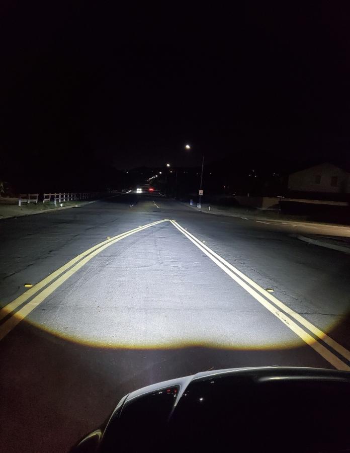

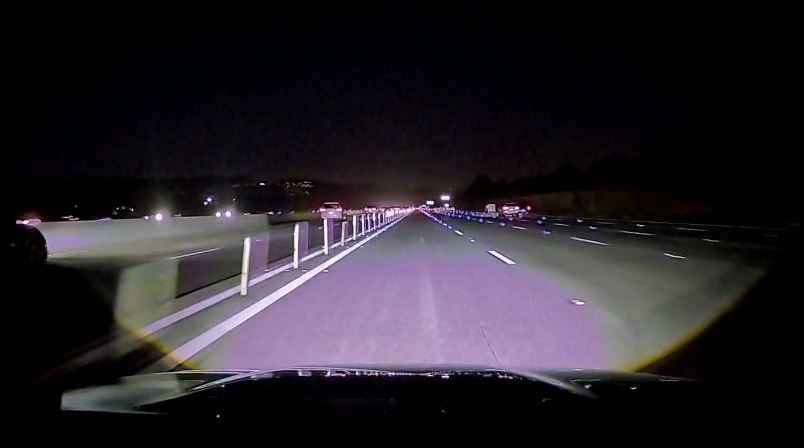

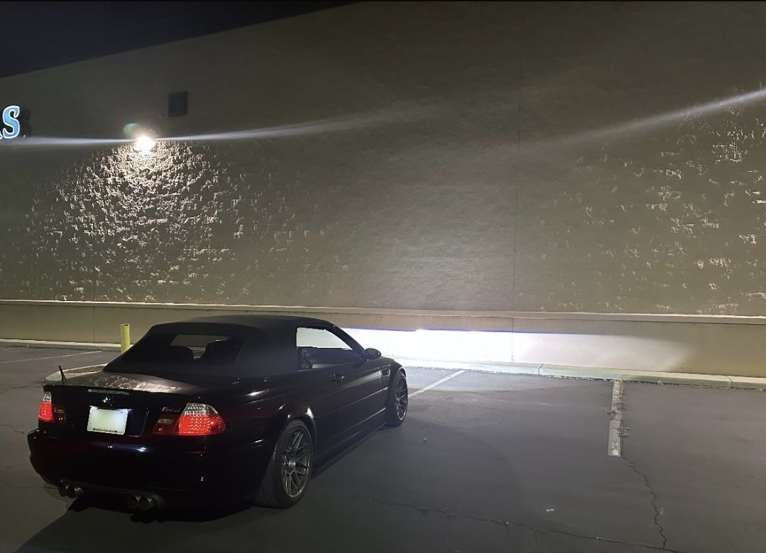

                        BI-LED retrofit - Sanvi projector
                        My xenons started going out so I started researching projector upgrades i.e. Osram Night Breakers etc. Eventually I reached out to a specialist named Grant who recommended a BI-LED setup. He said that the technology now surpasses the Osrams in terms of light output while costing the same if not less. Based on that, I had him build out a set for me with the option of a ballast delete to clean up the engine bay a bit (no need for the ballast since it’s LED now). Love the upgrade, it lights up everything for miles and the cutoff is crisp. I can’t go back to xenon’s after this, the amount of stuff you can see at night is so helpful. The headlights themselves look OEM so it’s a welcome addition.
                        Click image for larger version  Name:	Hedlight 1.jpg Views:	0 Size:	34.0 KB ID:	326047
                        Click image for larger version  Name:	hedlight 2.jpg Views:	0 Size:	127.6 KB ID:	326048
                        Click image for larger version  Name:	Screenshot_20251108_192046.jpg Views:	4 Size:	47.1 KB ID:	326120

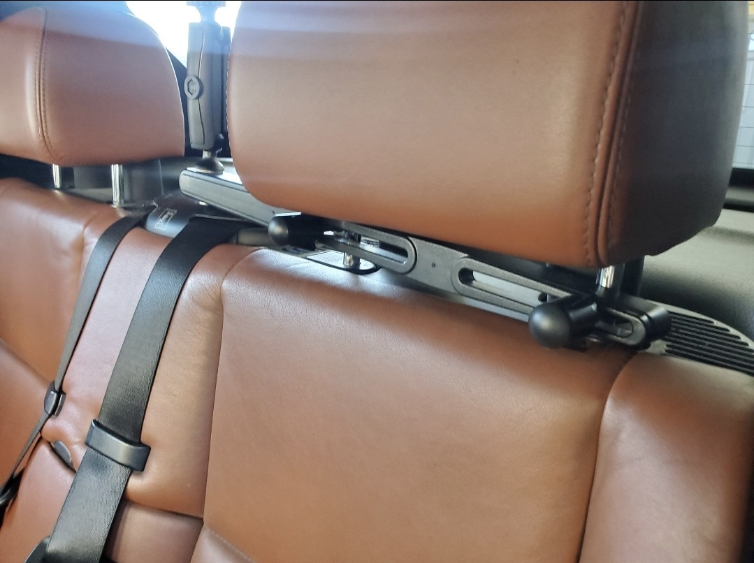

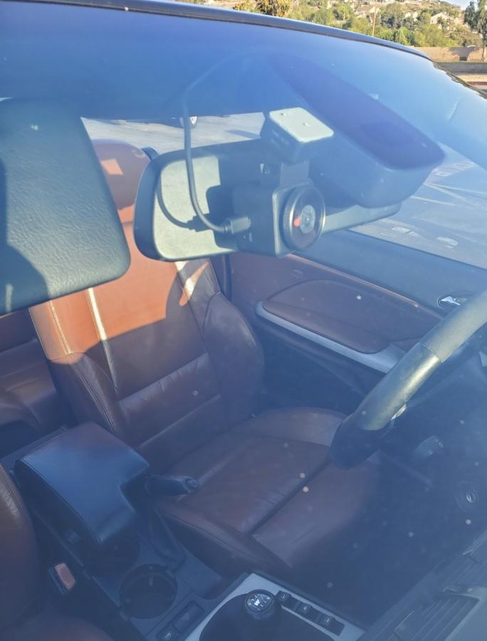

                        Vantrue Dashcam and Rear Seat Go-Pro bracket

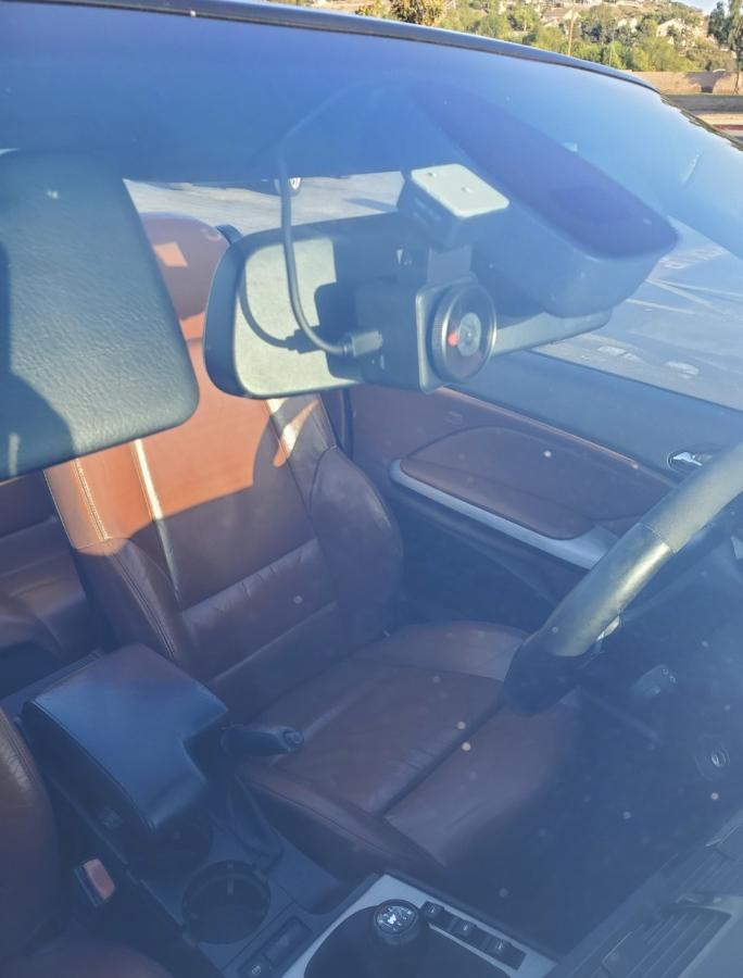

                        Got the E1 light on sale, I’d recommend it for everyone as an added insurance policy given how crazy people are on the road these days. Had it hardwired in (the have a low voltage kit) which monitors the car when parked and turns on when motion is detected.
                        Click image for larger version  Name:	vantru.jpg Views:	0 Size:	49.3 KB ID:	326050
                        Also got one of these to capture POV driving with the top down via Go-Pro:
                        Click image for larger version  Name:	Screenshot_20251104_140820.jpg Views:	0 Size:	145.3 KB ID:	326051
                        Click image for larger version  Name:	Screenshot_20251104_190833.jpg Views:	0 Size:	61.2 KB ID:	326052

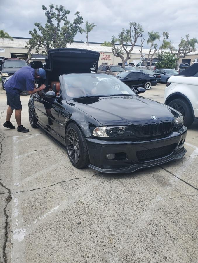

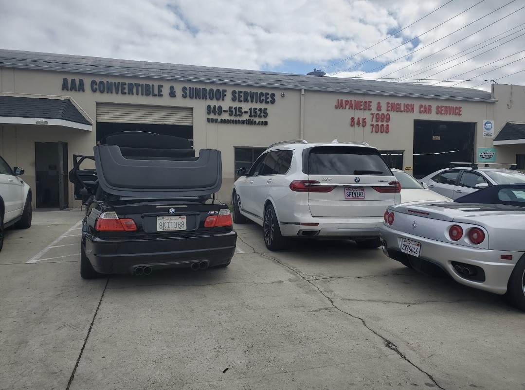

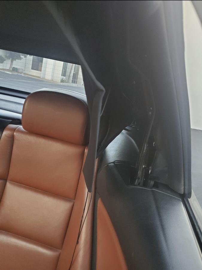

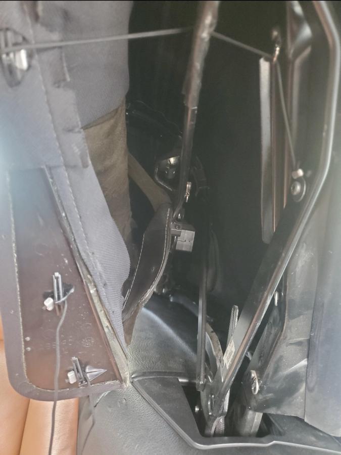

                        Convertible top maintenance: bat flap replaced and gears/latches serviced. Also the top was cleaned and treated. Given that I drive with the top down more often than not throughout the year (SoCal FTW), having this maintained is critical.
                        Click image for larger version  Name:	vert 3.jpg Views:	0 Size:	43.4 KB ID:	326053
                        Click image for larger version  Name:	vert 4.jpg Views:	0 Size:	57.3 KB ID:	326054
                        Click image for larger version  Name:	vert 1.jpg Views:	0 Size:	120.6 KB ID:	326055Click image for larger version  Name:	vert 2.jpg Views:	0 Size:	211.2 KB ID:	326056

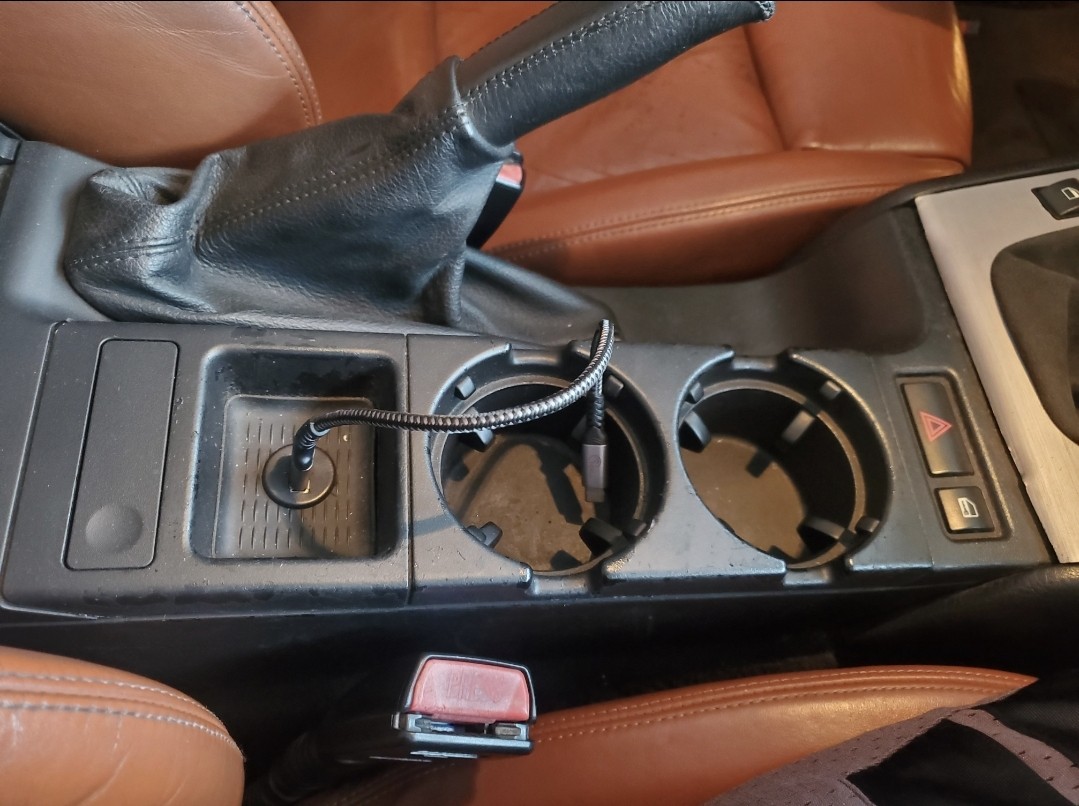

                        Android Auto: Apparently my kenwood system has it which I just recently found out, had my local shop relocate the USB to the coin tray area where I could plug my phone and have it sit in the cup holder.
                        Click image for larger version  Name:	android 1.jpg Views:	0 Size:	169.3 KB ID:	326057
