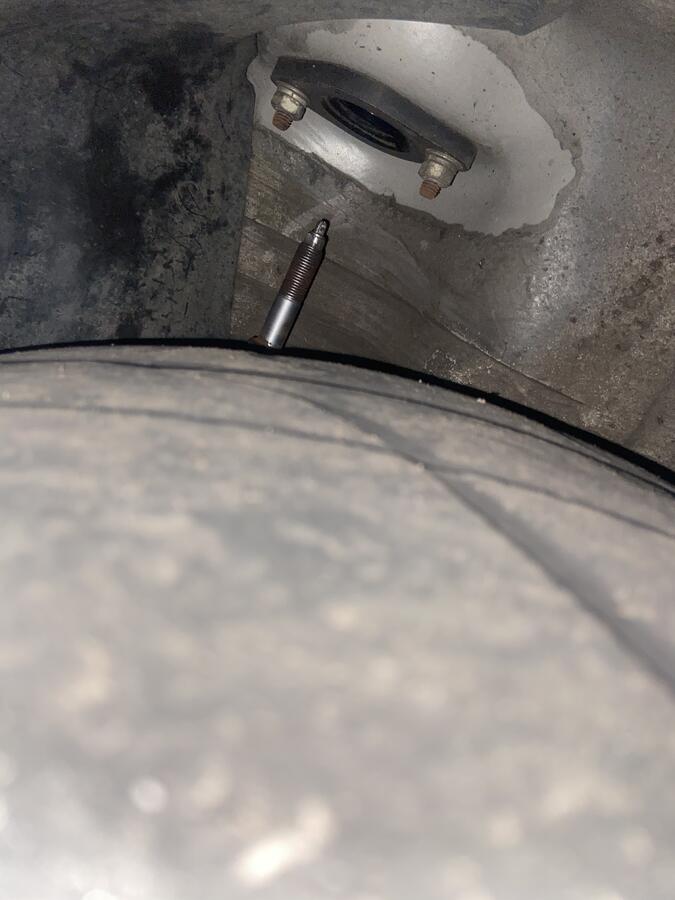

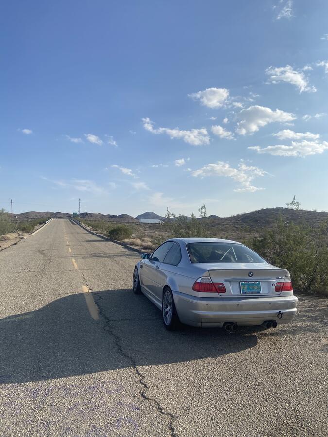

    After actually starting to drive the car, disaster struck. While driving, one of the rear shock mounts exploded. This left me stranded on the side of the road with my passenger rear strut hanging loose. Not the end of the world, right? Well, I was actually in New Mexico at the time, on my way back to LA (I was supposed to leave the next day.) This happened on a Monday, and I was supposed to leave town the next day (Tuesday) so I could be back in town on Wednesday for a fairly important meeting. I didn't have many options. A) Fly home, leave the car at the airport and figure something out in the meantime, B) Take the car to a shop, have them try to figure things out (no performance shops in town mind you) or C) Remove the rear damper entirely so it didn't knock around, and limp the car ~700mi back home. For better or worse, I ultimately decided on option C.
    The issue:
    Click image for larger version  Name:	IMG_9222.jpeg Views:	0 Size:	51.4 KB ID:	130515
    Somewhere in the middle of nowhere, with only one rear damper:
    Click image for larger version  Name:	IMG_9265.jpeg Views:	0 Size:	96.4 KB ID:	130517
    Thankfully, I made it back into LA without any issues. To my surprise, the car did great with only one rear damper on the ride back. Just had to take extra care over bumps, as the car would tend to oversteer. Yikes. Now the car was back in LA, with all my shops...I had to make a decision, replace the rear shock mounts. Or replace the coil-overs altogether. I decided upon the latter, ordering a set of Ohlins dedicated track coil-overs as soon as I got back into town, along with some BimmerWorld rear camber arms, and BimmerWorld end links (all over-nighted, as this is my only real car at the moment!)

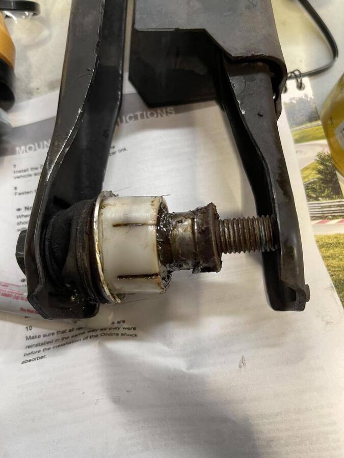

    Camber arm bushings:
    Click image for larger version  Name:	df9c8d5f339c2bb74a60496e0f75752bbd8033da.jpg Views:	0 Size:	63.2 KB ID:	130520

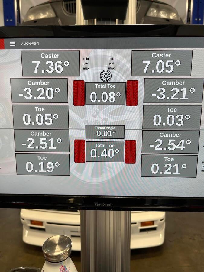

    New alignment specs:
    Click image for larger version  Name:	IMG_9369.jpeg Views:	0 Size:	90.3 KB ID:	130521

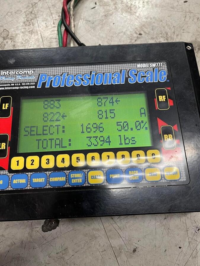

    Cornerbalance / Weight specs (Note 180lbs of ballast in weight to account for driver), actual weight: 3,214lbs:
    Click image for larger version  Name:	IMG_9370.jpeg Views:	0 Size:	112.7 KB ID:	130522

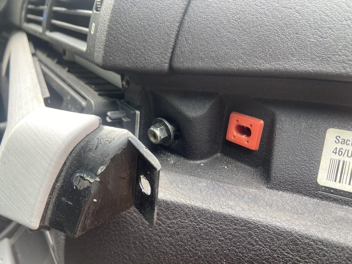

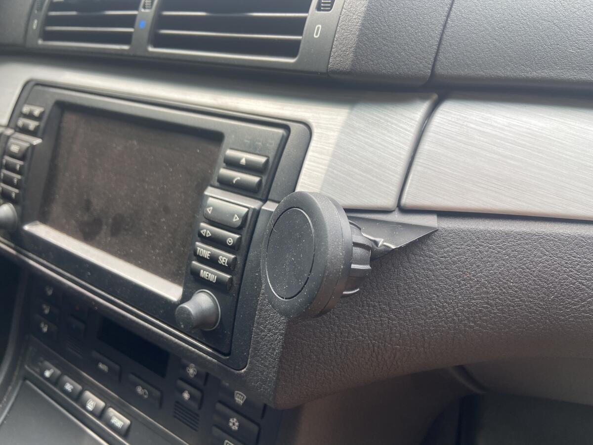

                Finally got around to doing some smaller mods. The first of which is a rennline 'phone mount' -- very easy install. Great location. Couldn't imagine getting a different mount.
                During installation:
                Finished product:

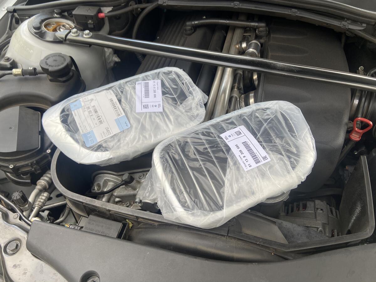

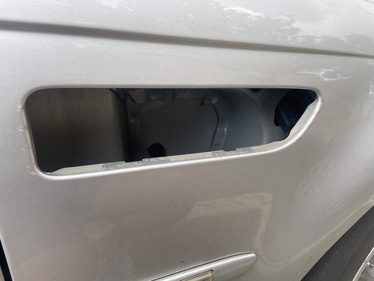

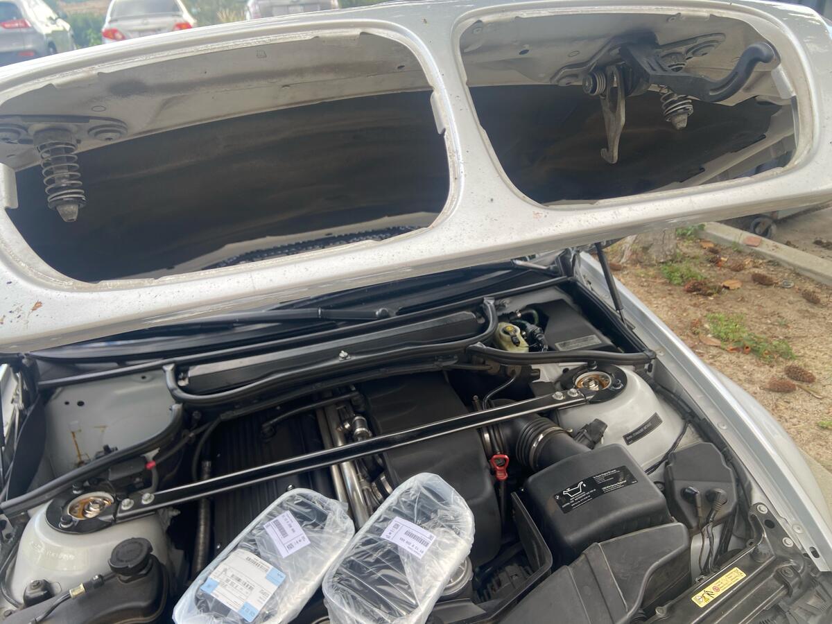

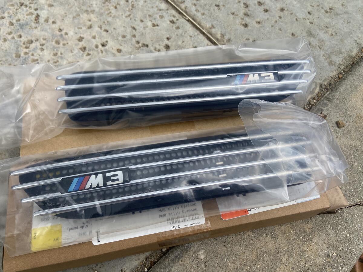

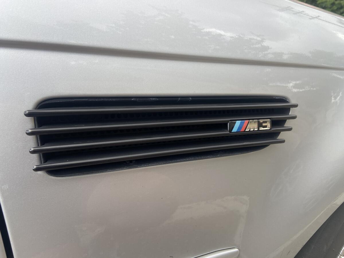

                I was also able to source some OE, brand new in packaging, front & side chrome grilles. The black grilles were really bothering me; the goal for this car is to go completely OE+ on the exterior. I will also be sourcing OE orange side reflectors to match.

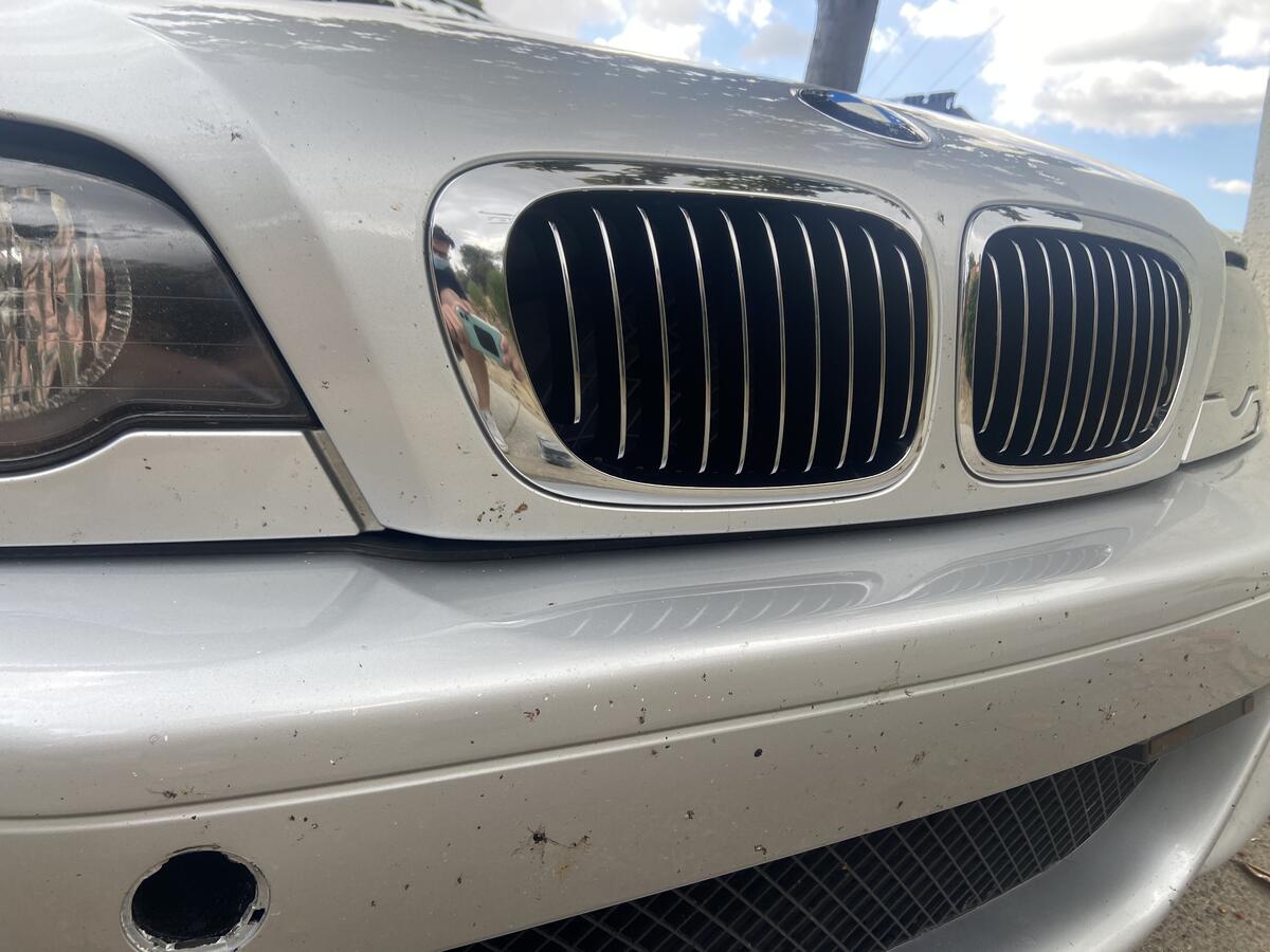

                Front grilles:

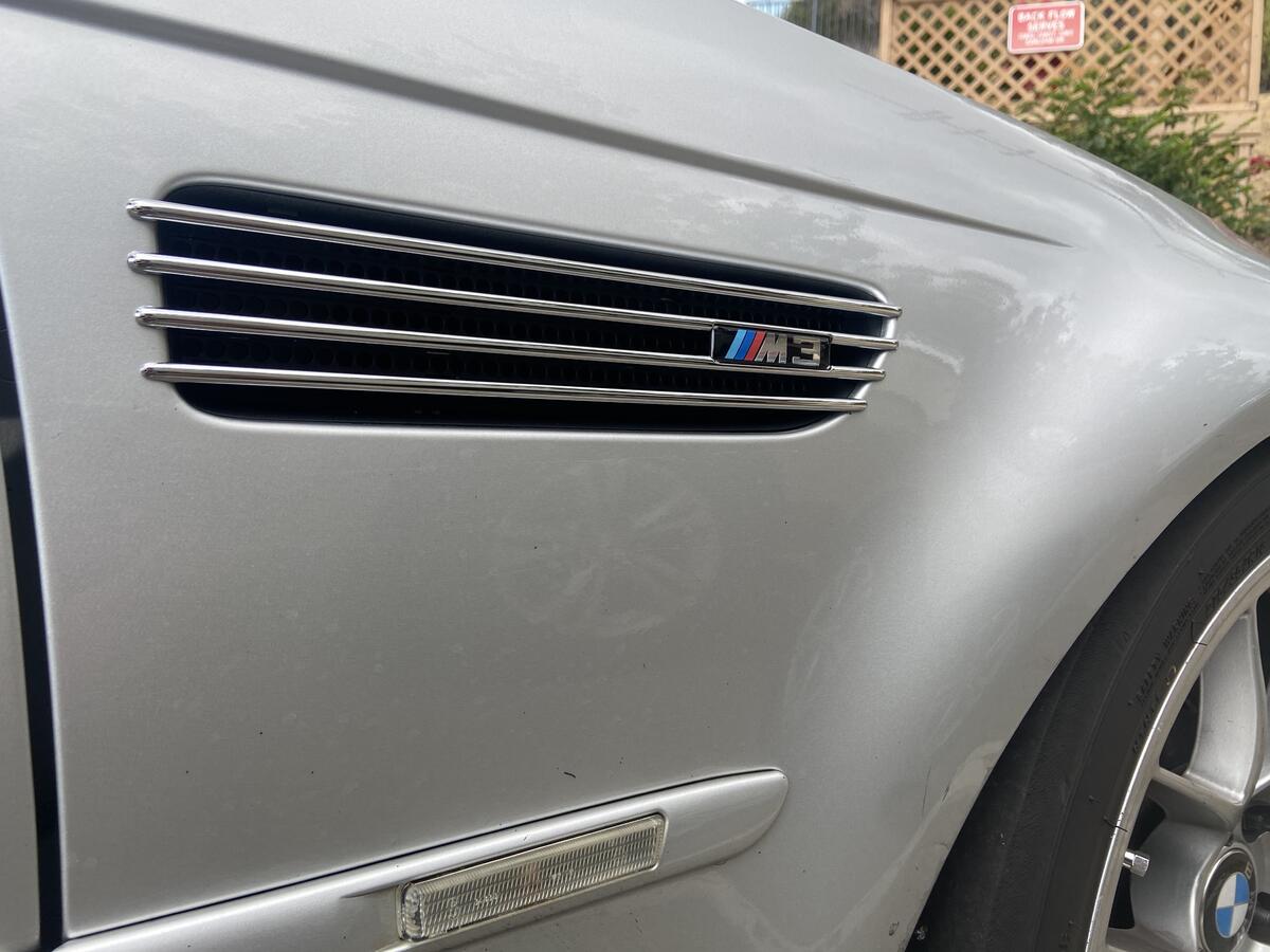

                Side grilles:
