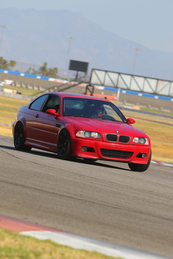

    Took it to our second track day. Ran a 2:15.xx at Auto Club Speedway Roval, according to Harry's Lap Timer. Mostly just having fun with friends, letting off a little steam, and getting to know a RWD chassis more (came from a '11 STI). Seriously fun how this car can rotate with throttle application.

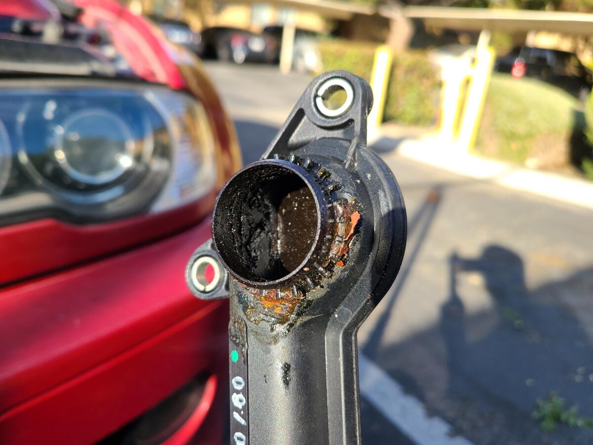

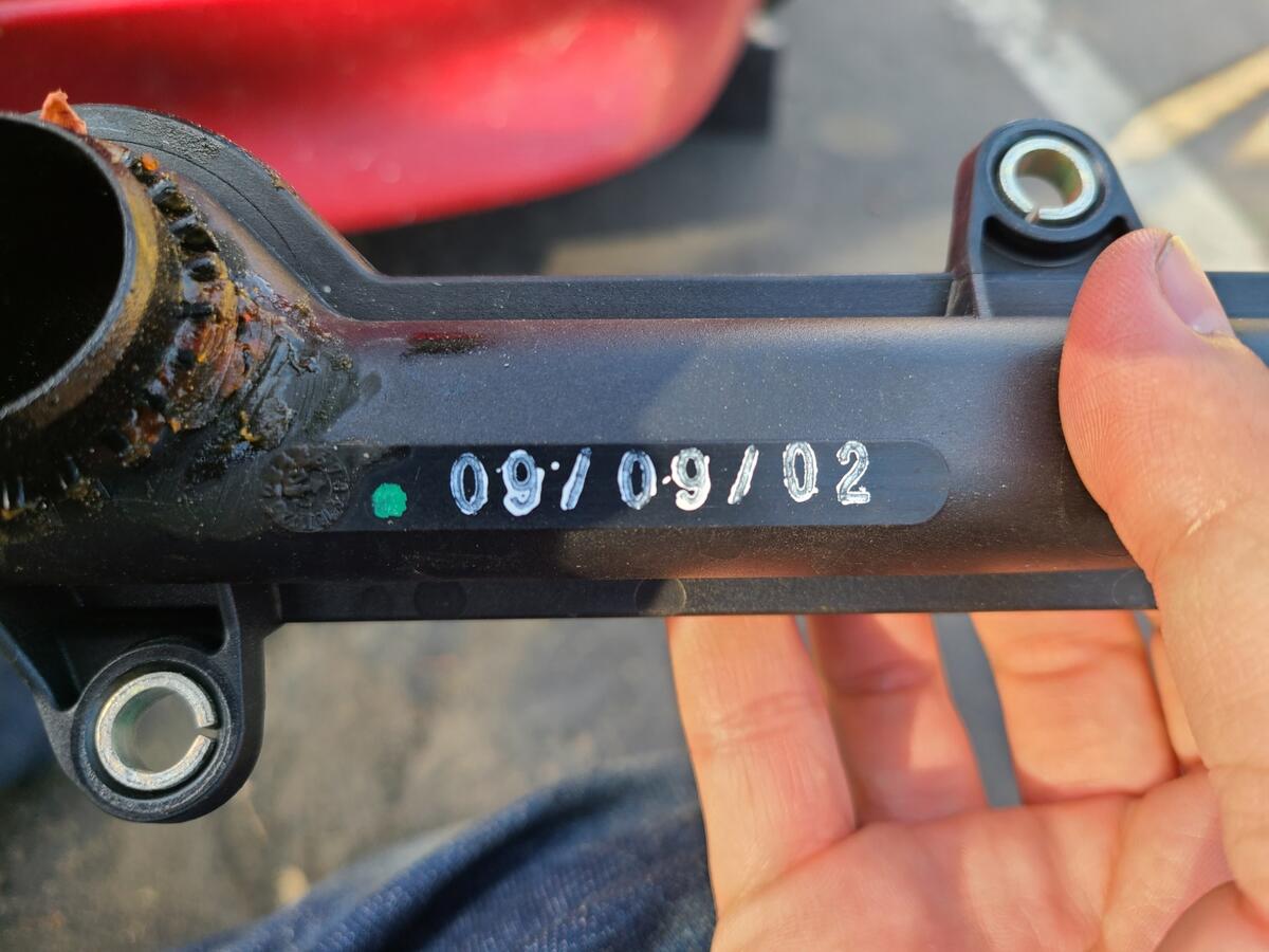

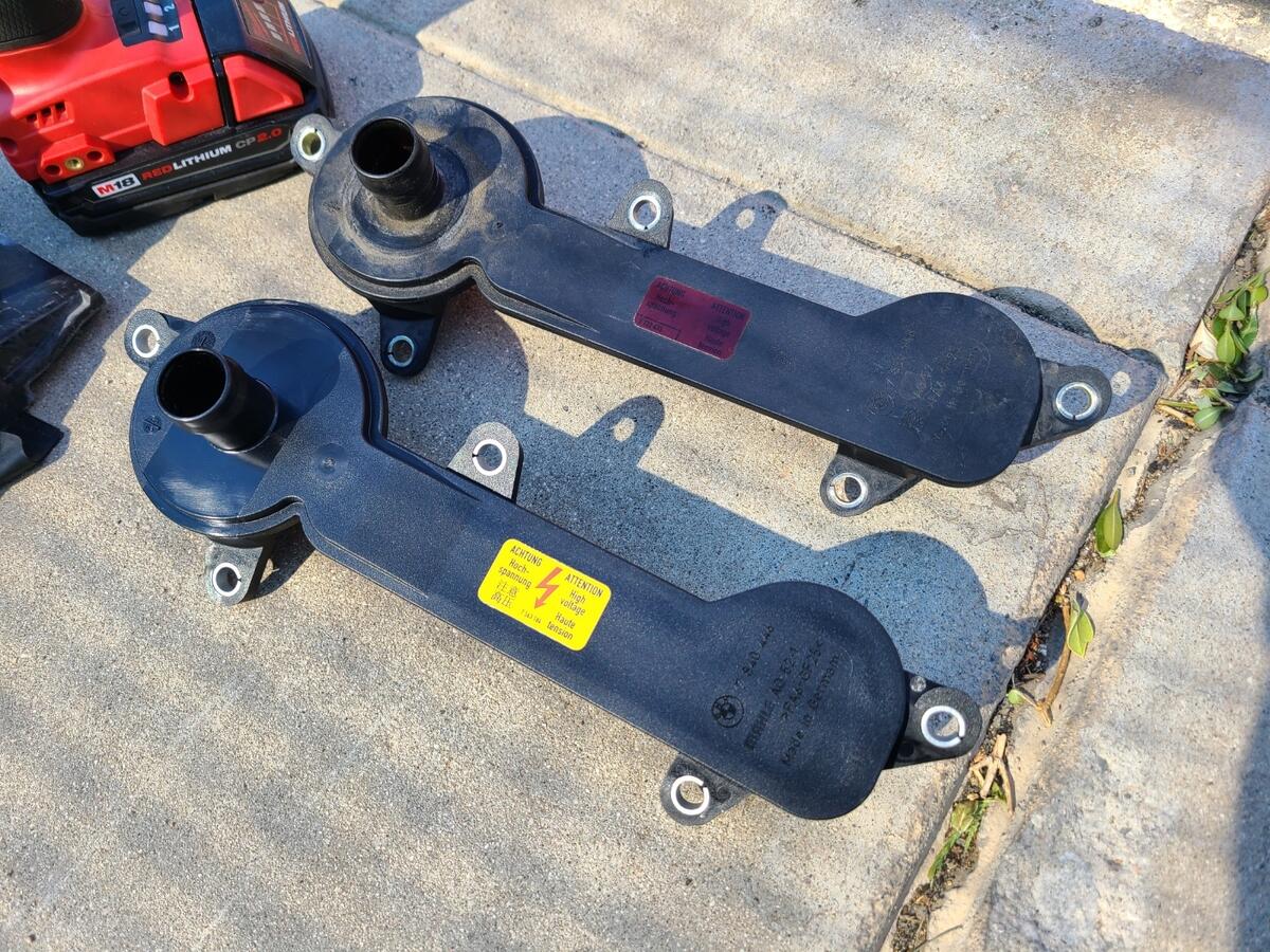

              Ever since I've had the car, it was always wet with oil around the oil fill cap and it always smelled like oil when I revved it out. I thought it was the oil fill cap leaking so I replaced it. It didn't fix the weeping oil and the oiI smell was still there so I figured it was the AOS being clogged up that was behind it all (clogged = pressure build up = leaking cap). It was quick to swap but I forgot to order a new o-ring so I'll have to do it again when it comes in. It has helped with the oil smell and I'll have to check to see if the oil stops appearing around the oil fill cap.

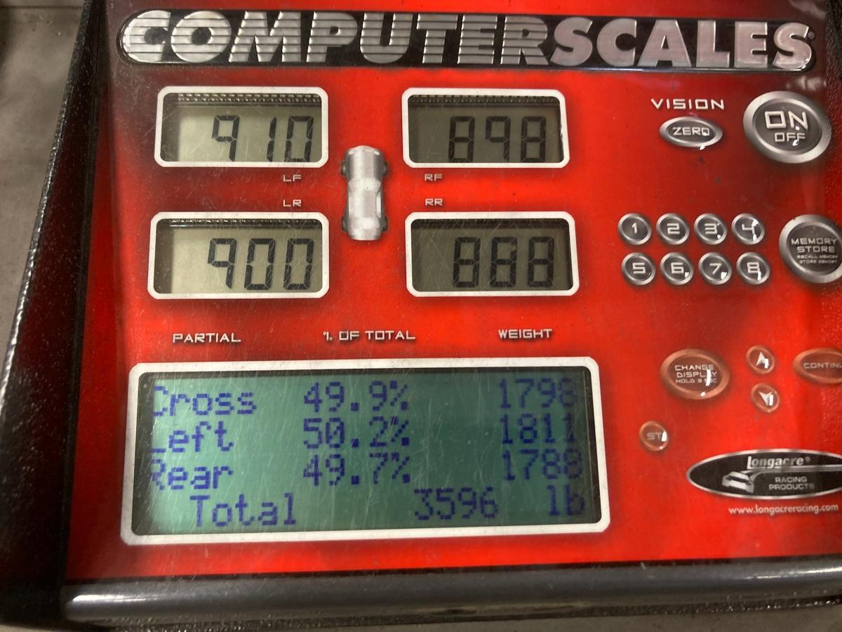

                First was getting it corner balanced and aligned again at Chewerks after re-installing GC Street camber plates on it. The GC Race plates I had on it had taken a good beating over the 2 years and the top spherical bearing was rattling.

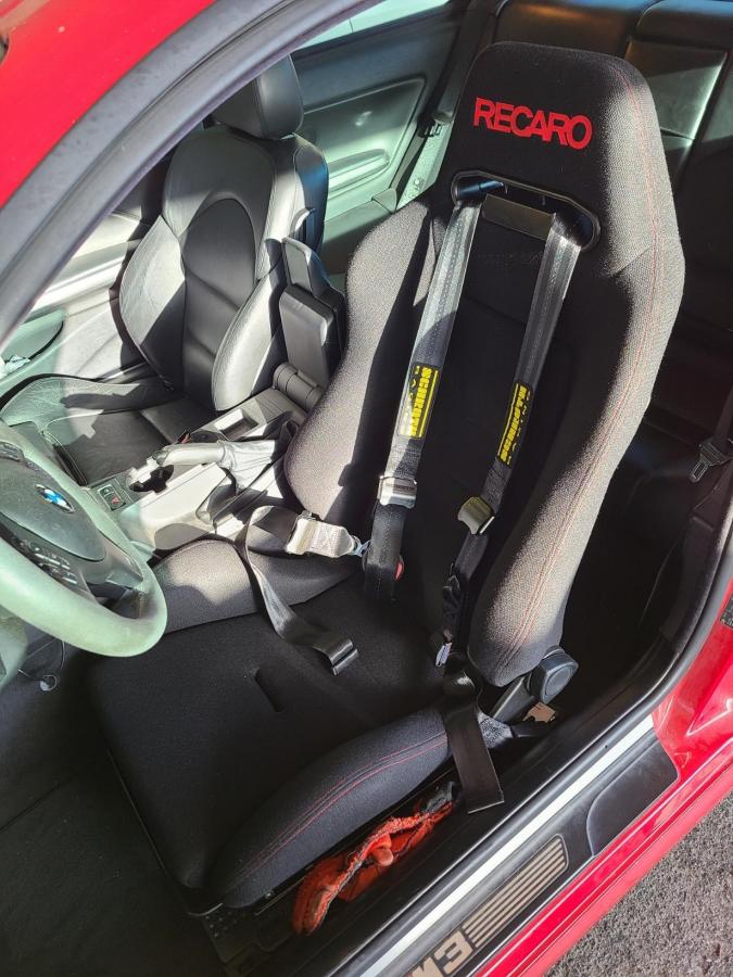

                  Felt productive so next up was swapping out the Bride Euroster II seat for a Recaro Speed and adding a Schroth Rallye 4 Quick-Fit harness.
                  The Recaro Speed has much more supportive bolsters, convenient seat fold forward for rear seat access, and a lower seating position, but it was not a simple bolt-in installation. I had to make a few extra holes in the sliders in order for them to fit the base mounts I have. Ultimately, they're a nice upgrade from the Bride seat. I'll have to work on getting the passenger seat installed in it sometime down the line.

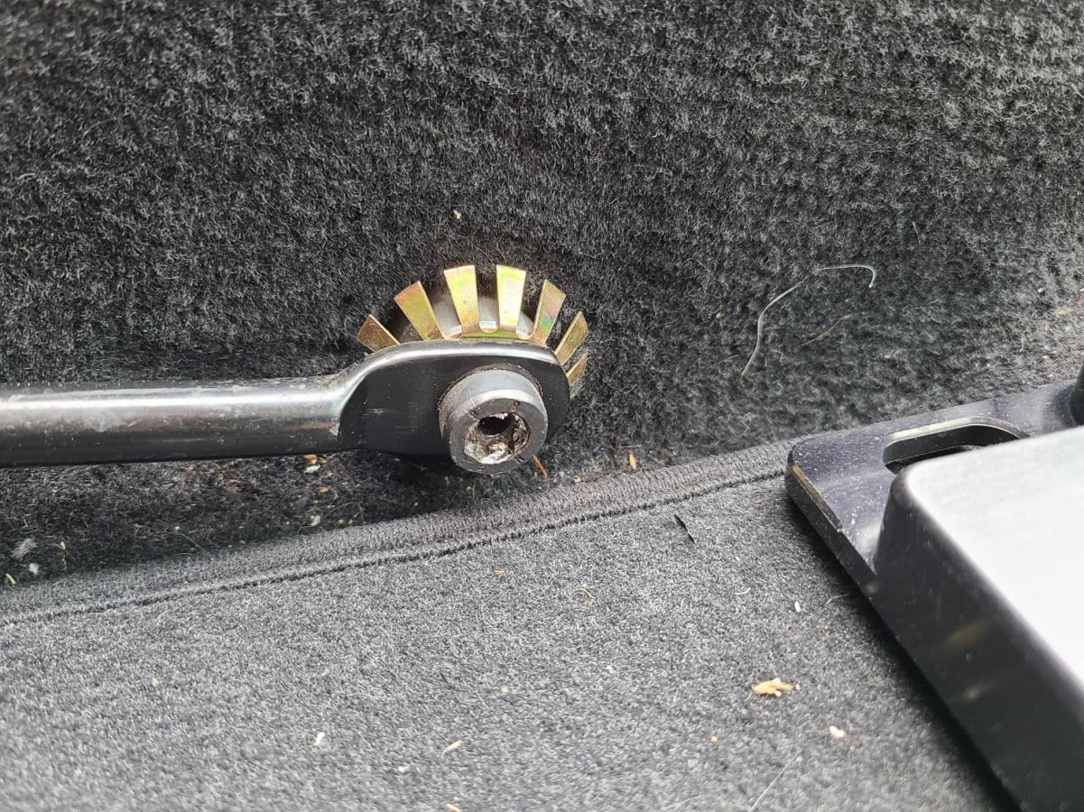

                  Ran into a snag while installing the Schroth harness. Used a T50 bit but it seemed like the bolt for the seat belt bar was very soft. It was a moment of panic while I tried to figure out how to get it out. My dad, being a former mechanic with 30+ years of experience, suggested I take a hammer to it and use a pair of Visegrips to clamp on it. It worked. No need for a bolt extractor when brute force does it just fine haha. I bought a replacement socket head cap screw (Grade 12.9) to replace it.

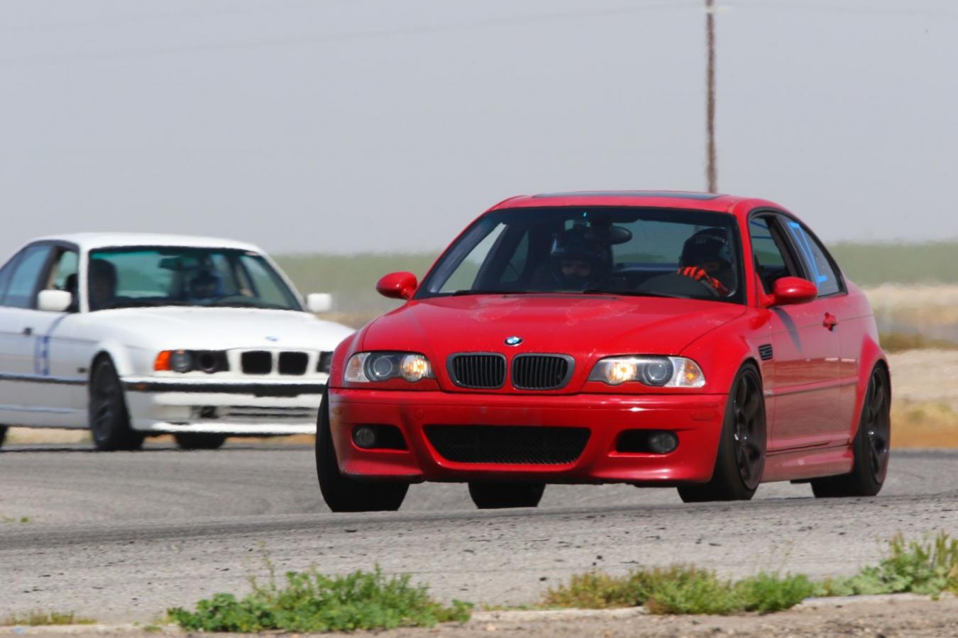

                        Yesterday, had my first track day with the M3 at Buttonwillow.
                        Those General G-Max RS tires actually held up pretty well until it started getting hot.
                        Engine temp got hot once but not enough to turn on the "oh shit" overheating light. It was usually hanging out around the 2nd dot most sessions. Oil temp was hanging out around the dot above middle (255?).
                        Only spun out once when I was coming out of On-ramp/Buttonhook and I got on the power too early/enthusiastically.
                        Harry's Lap Timer said I did a 2:17. An OK time but I'm happy with it.
