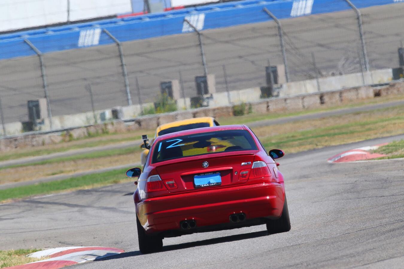

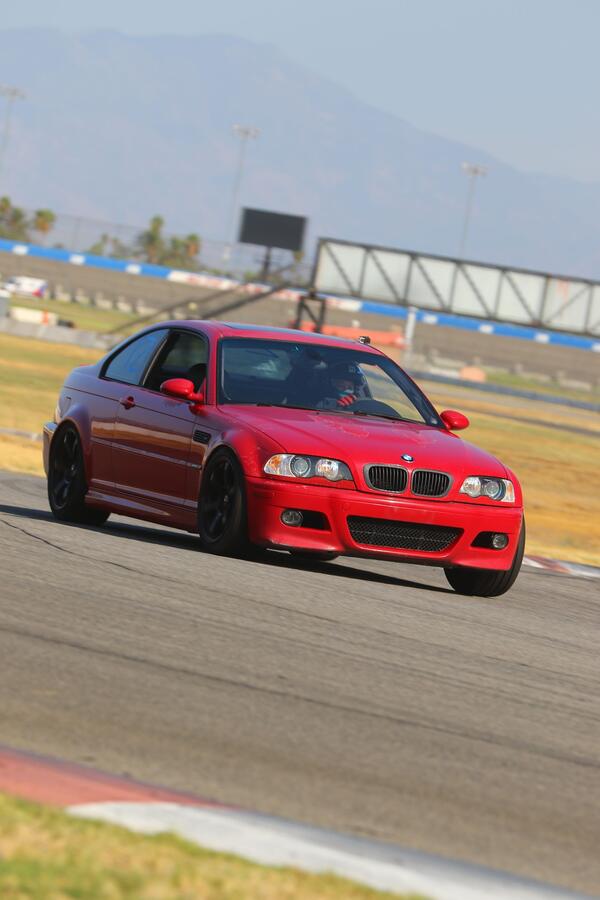

    Took it to our second track day. Ran a 2:15.xx at Auto Club Speedway Roval, according to Harry's Lap Timer. Mostly just having fun with friends, letting off a little steam, and getting to know a RWD chassis more (came from a '11 STI). Seriously fun how this car can rotate with throttle application.

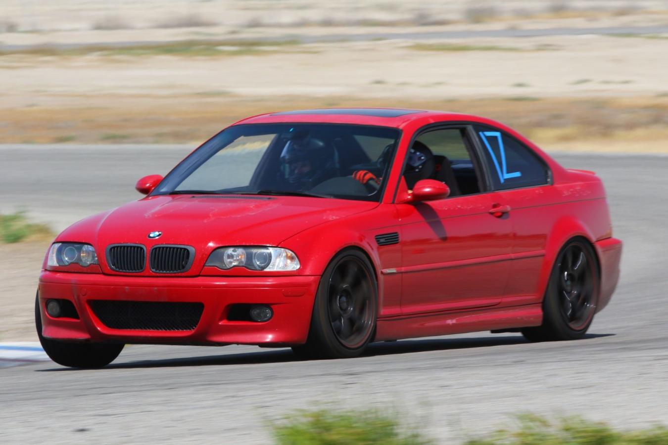

                        Yesterday, had my first track day with the M3 at Buttonwillow.
                        Those General G-Max RS tires actually held up pretty well until it started getting hot.
                        Engine temp got hot once but not enough to turn on the "oh shit" overheating light. It was usually hanging out around the 2nd dot most sessions. Oil temp was hanging out around the dot above middle (255?).
                        Only spun out once when I was coming out of On-ramp/Buttonhook and I got on the power too early/enthusiastically.
                        Harry's Lap Timer said I did a 2:17. An OK time but I'm happy with it.

                          punishing that front left tire
