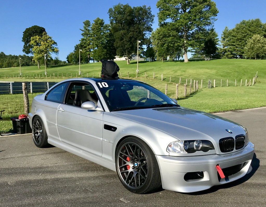

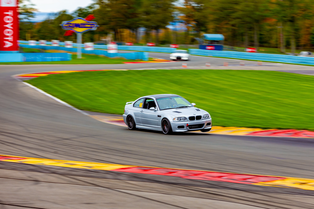

    It didn't get much love in 2021 as I was focused on the street build but still managed a few track days. Most recently Watkins Glen in October 2022. With the Rosso car basically now done, there is a lot I plan do now do on this car including suspension upgrades and some exterior updates. More to come!
    Click image for larger version  Name:	51792822138_760ac19151_b.jpg Views:	156 Size:	186.6 KB ID:	147346​

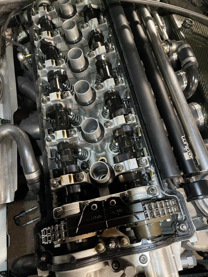

          Engine Updates from 2015 to Present.

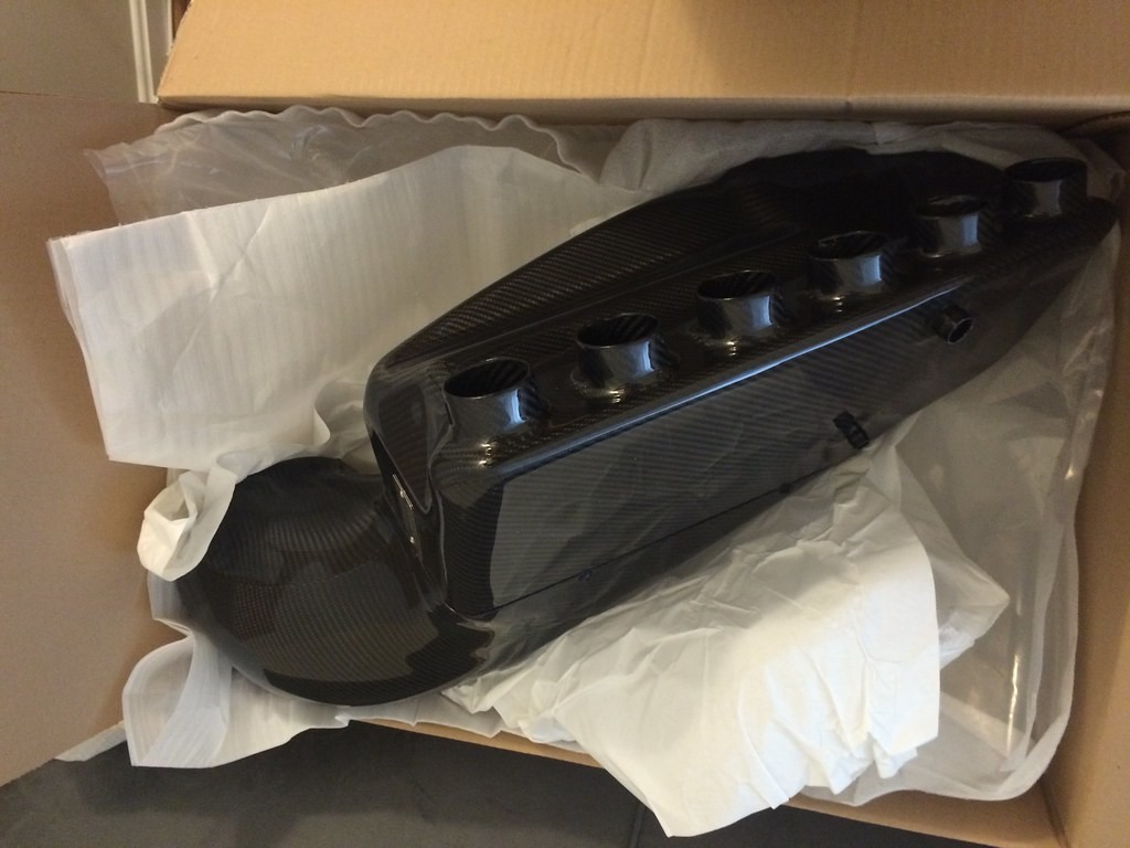

          When I picked up this car I knew the first thing I wanted was a CSL style airbox. In 2016 I joined an M3Forum group buy for an Evolve box and started my S54 modifications.
          Click image for larger version  Name:	24573333713_2d66332c90_b.jpg Views:	0 Size:	120.0 KB ID:	152437

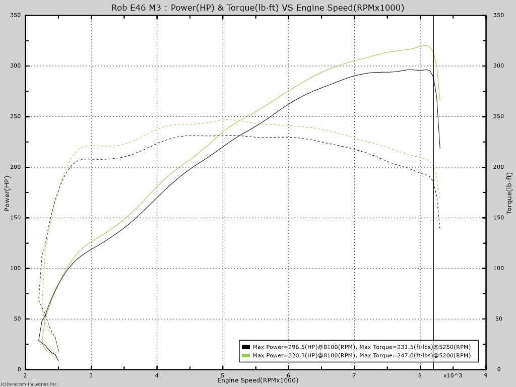

          I went with a TTFS CSL tune with a converted HP DME. I also installed Fabspeed headers and catless section 1.
          Click image for larger version  Name:	25923487911_de88ba87f7_b.jpg Views:	0 Size:	160.1 KB ID:	152438

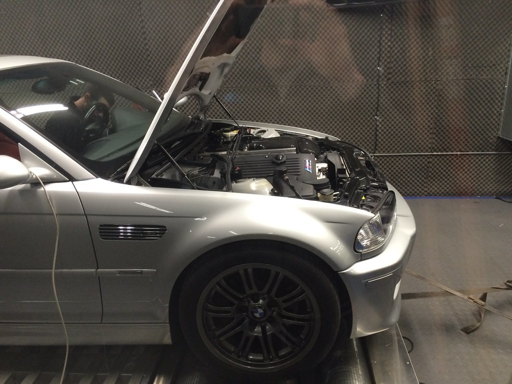

          Those modifications got me to around 320 WHP.
          Click image for larger version  Name:	26453503853_bc7b933e8f_b.jpg Views:	0 Size:	111.9 KB ID:	152439

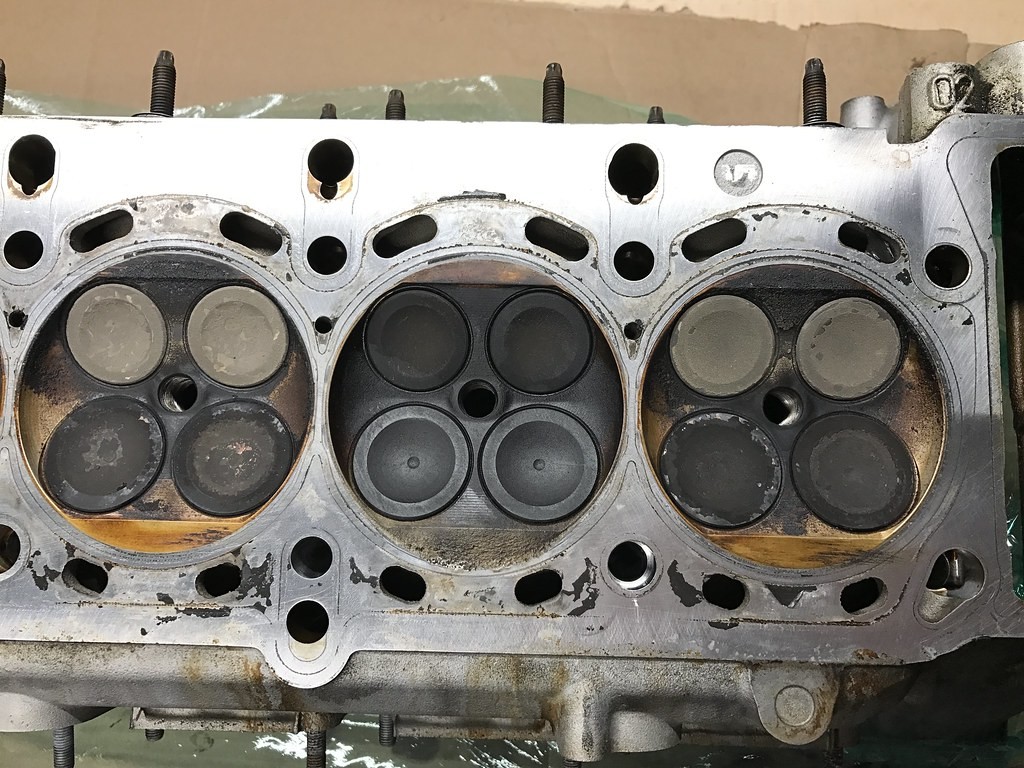

          I ran this setup for about a year until two unfortunates events. First, after moving back to NYC I found out that the CSL tune can not be read by NY inspection. Second, the motor started overheating while I was on the track at NJMP. I suspected a blown head gasket, so in the winter of 2016 I decided to pull the head. Fortunately it wasn't the head gasket. Unfortunately it was a piston failure... The ring landing on piston 2 had cracked and the extra friction/heat had damaged the piston and head.
          Click image for larger version  Name:	31461012964_9e6a16ce9f_b.jpg Views:	0 Size:	261.7 KB ID:	152440
          Click image for larger version  Name:	32312988105_fbf19b70c3_b.jpg Views:	0 Size:	244.1 KB ID:	152441
          So decided to do a full engine rebuild. Which was an adventure....

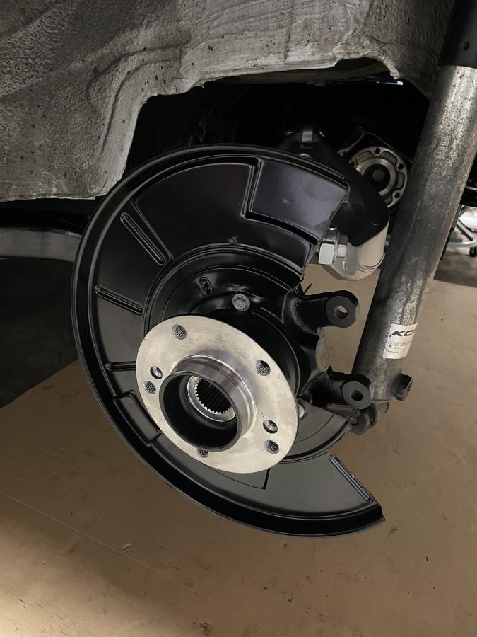

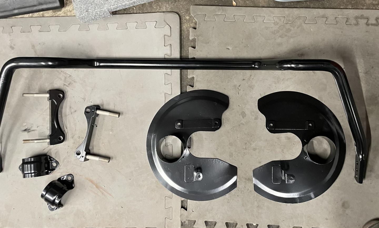

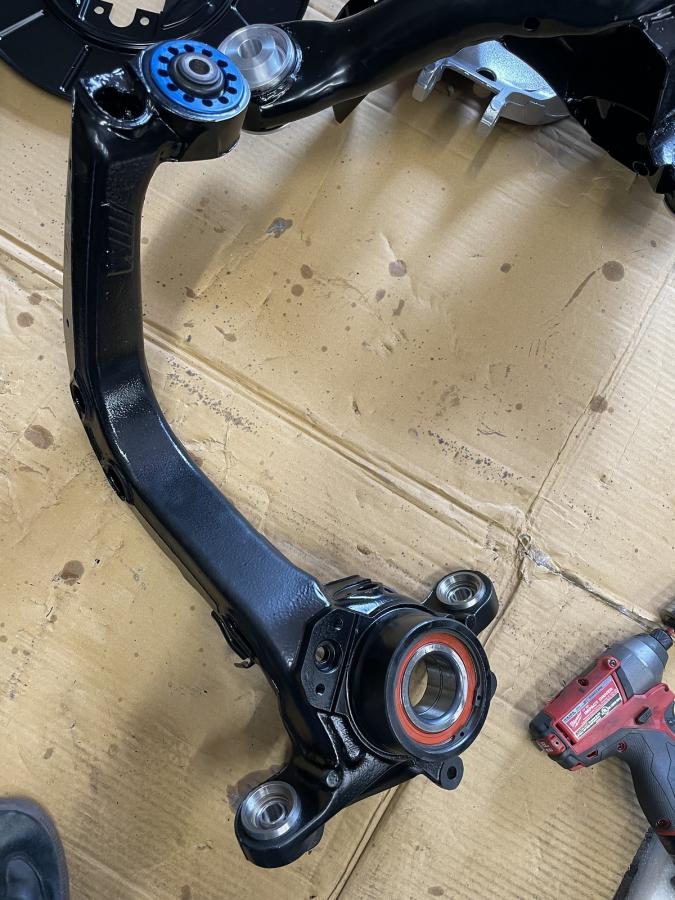

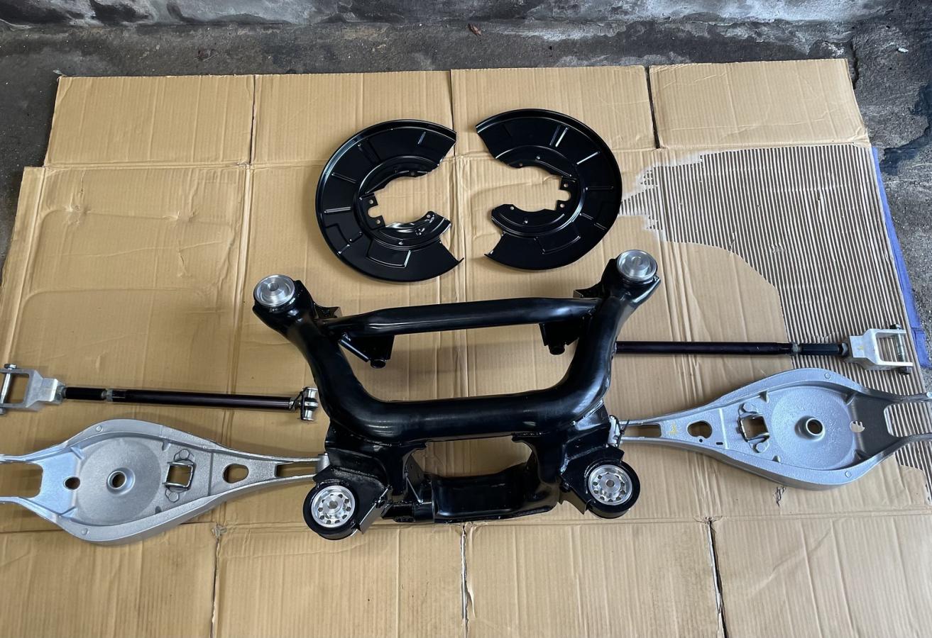

                  First I got the spare parts all powder coated including brackets, braces etc..
                  Click image for larger version  Name:	51760077090_80fb19c5c3_h.jpg Views:	0 Size:	206.3 KB ID:	161474

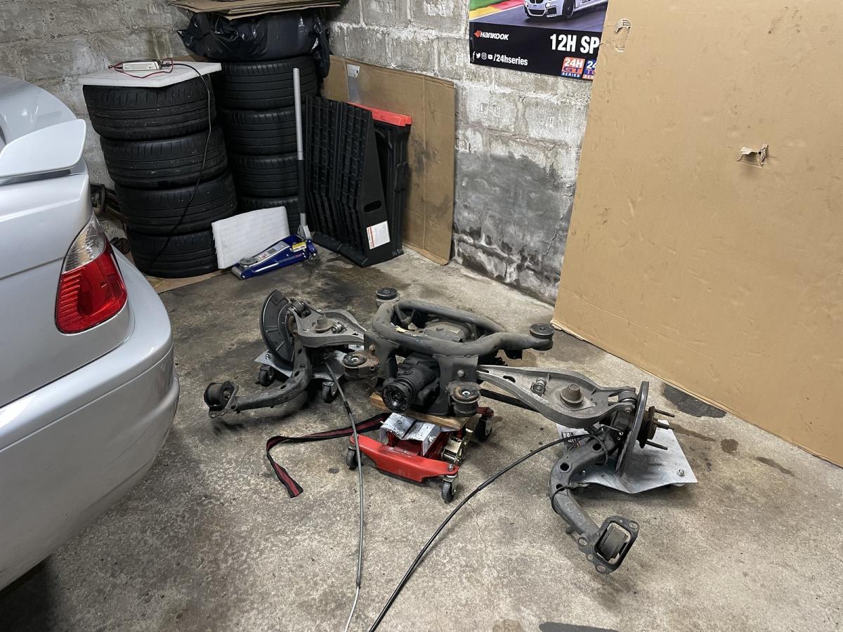

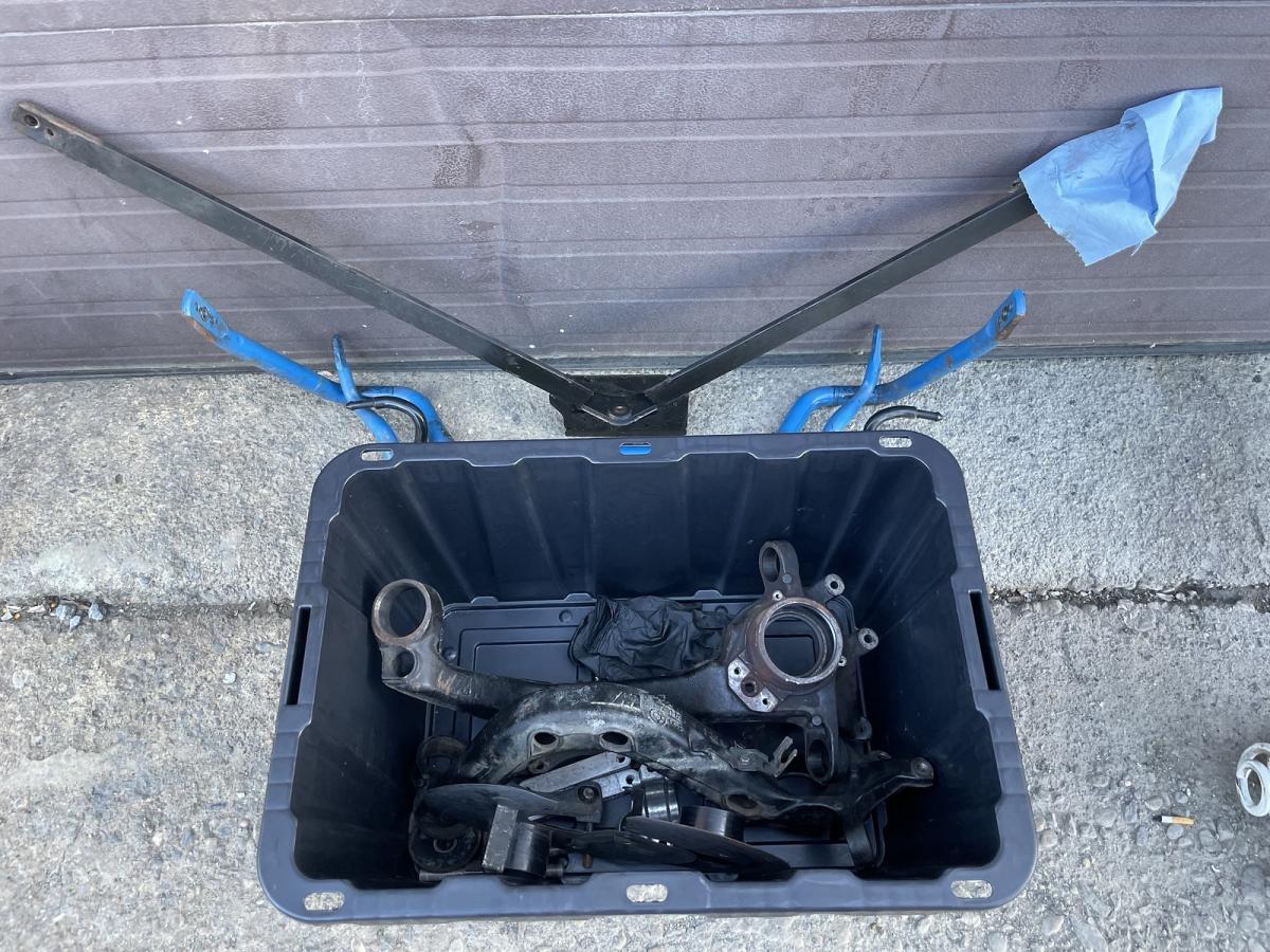

                  Old subframe coming out. Im getting very efficient at this...
                  Click image for larger version  Name:	51866797133_14e9861681_h.jpg Views:	0 Size:	191.0 KB ID:	161481
                  Click image for larger version  Name:	51928061461_5224dea936_k.jpg Views:	0 Size:	158.8 KB ID:	161475
                  Click image for larger version  Name:	51927087332_40a3ba7b57_h.jpg Views:	0 Size:	194.2 KB ID:	161476

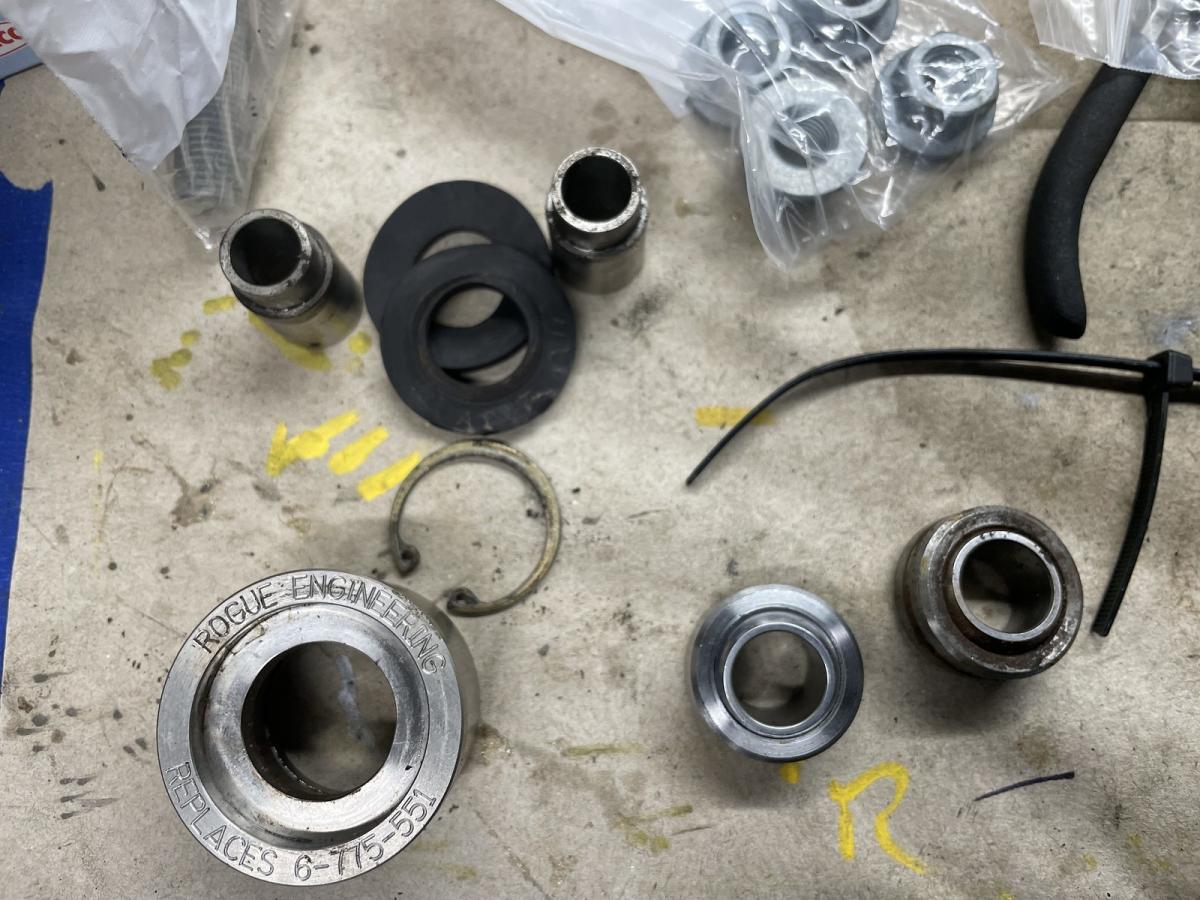

                  Also rebuild all the RE bearing that were already on the car. Very easy and well designed by Ben at Rogue. Got new bearings from Summit Racing:
                  Click image for larger version  Name:	51928692385_76708b7e92_h.jpg Views:	0 Size:	151.8 KB ID:	161478

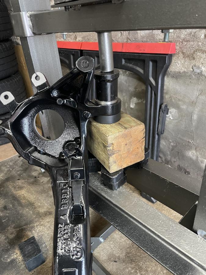

                  Used my new HF press to get all the bearings/bushings installed. Should have bought one of these years ago, makes this all so much!!
                  Click image for larger version  Name:	51928403414_71f67d9132_h.jpg Views:	0 Size:	122.2 KB ID:	161479
                  Done!
                  Click image for larger version  Name:	51928150308_b3241a2967_h.jpg Views:	0 Size:	102.9 KB ID:	161480

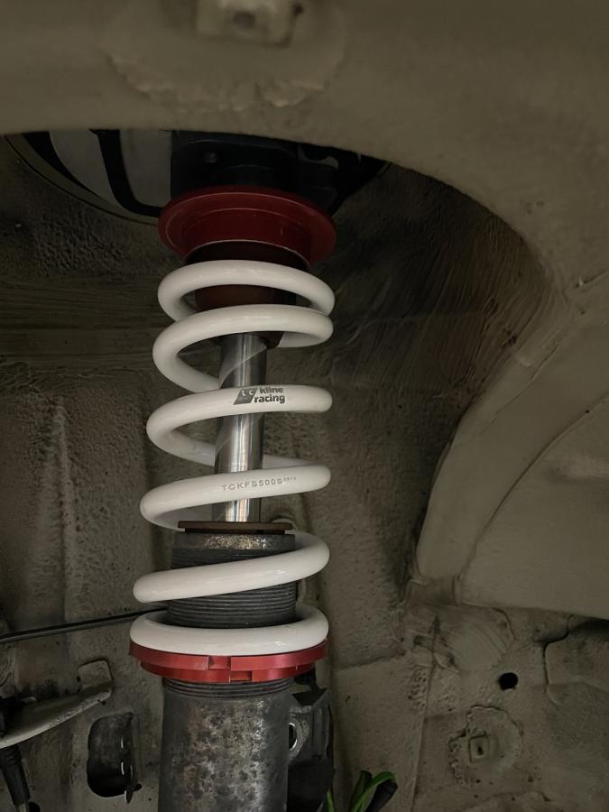

                  Almost back together! I stuck with my current TCKline dual adjustable dampers and upped the spring rates to the highest he recommended (500/600)
                  Click image for larger version  Name:	51956471691_88ed3fc793_h.jpg Views:	0 Size:	73.9 KB ID:	161482
                  Click image for larger version  Name:	51793334844_ed5fb8b600_h.jpg Views:	0 Size:	56.6 KB ID:	161483

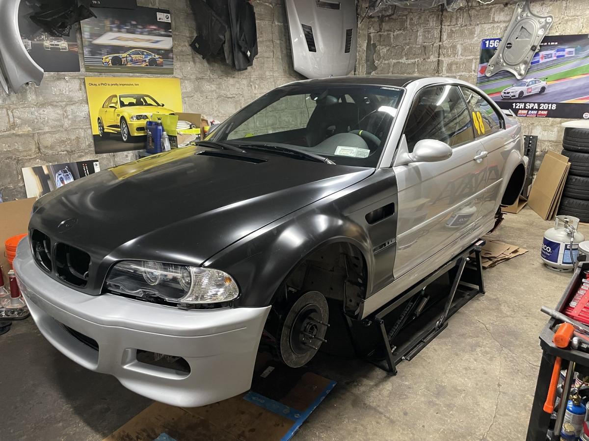

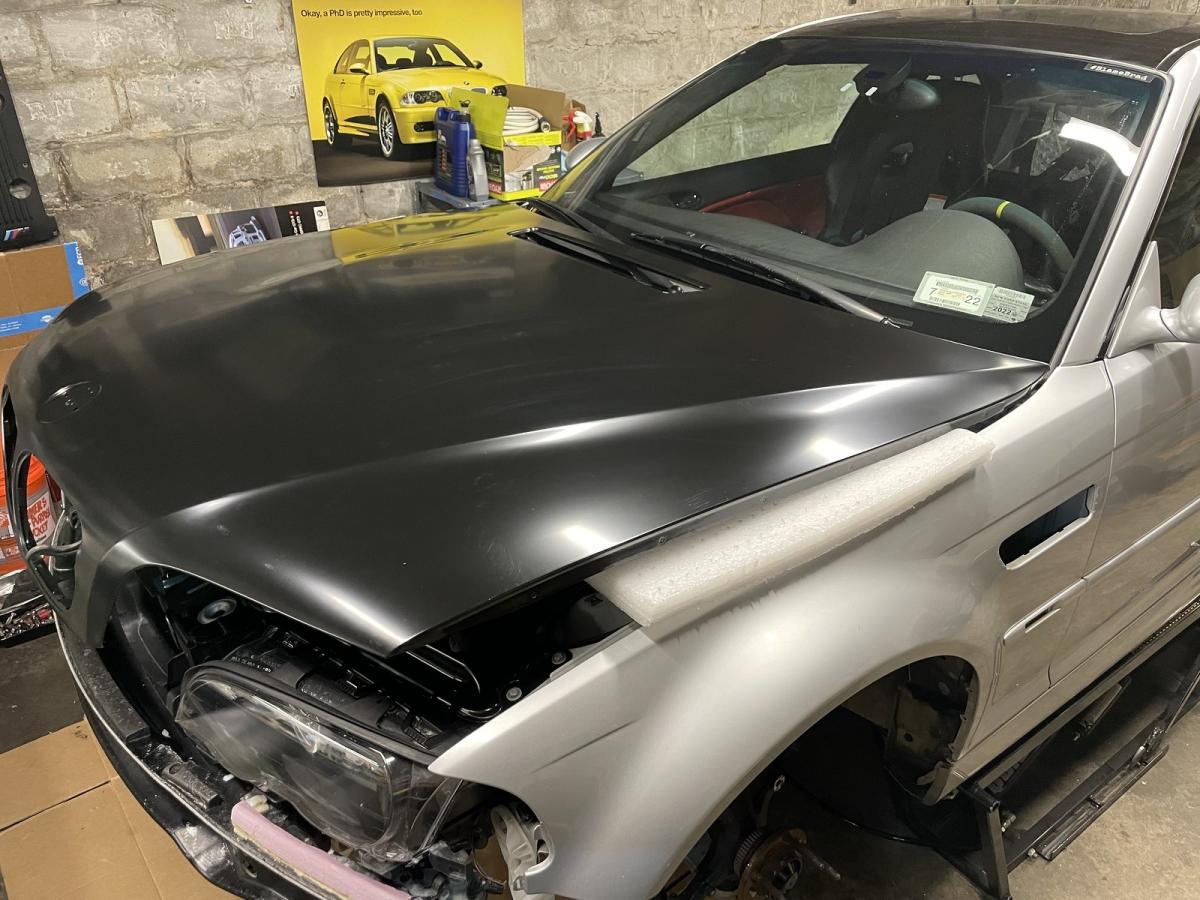

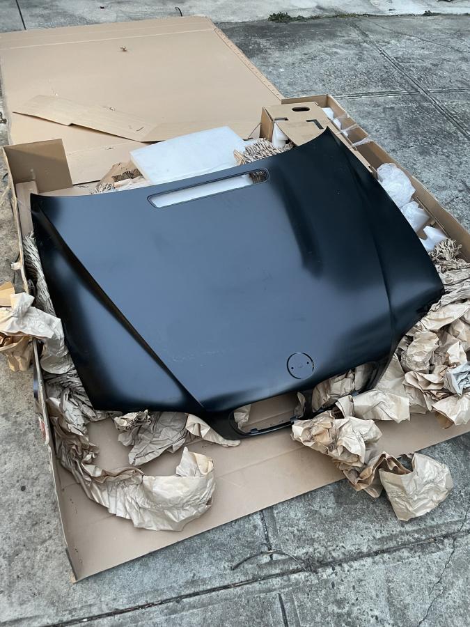

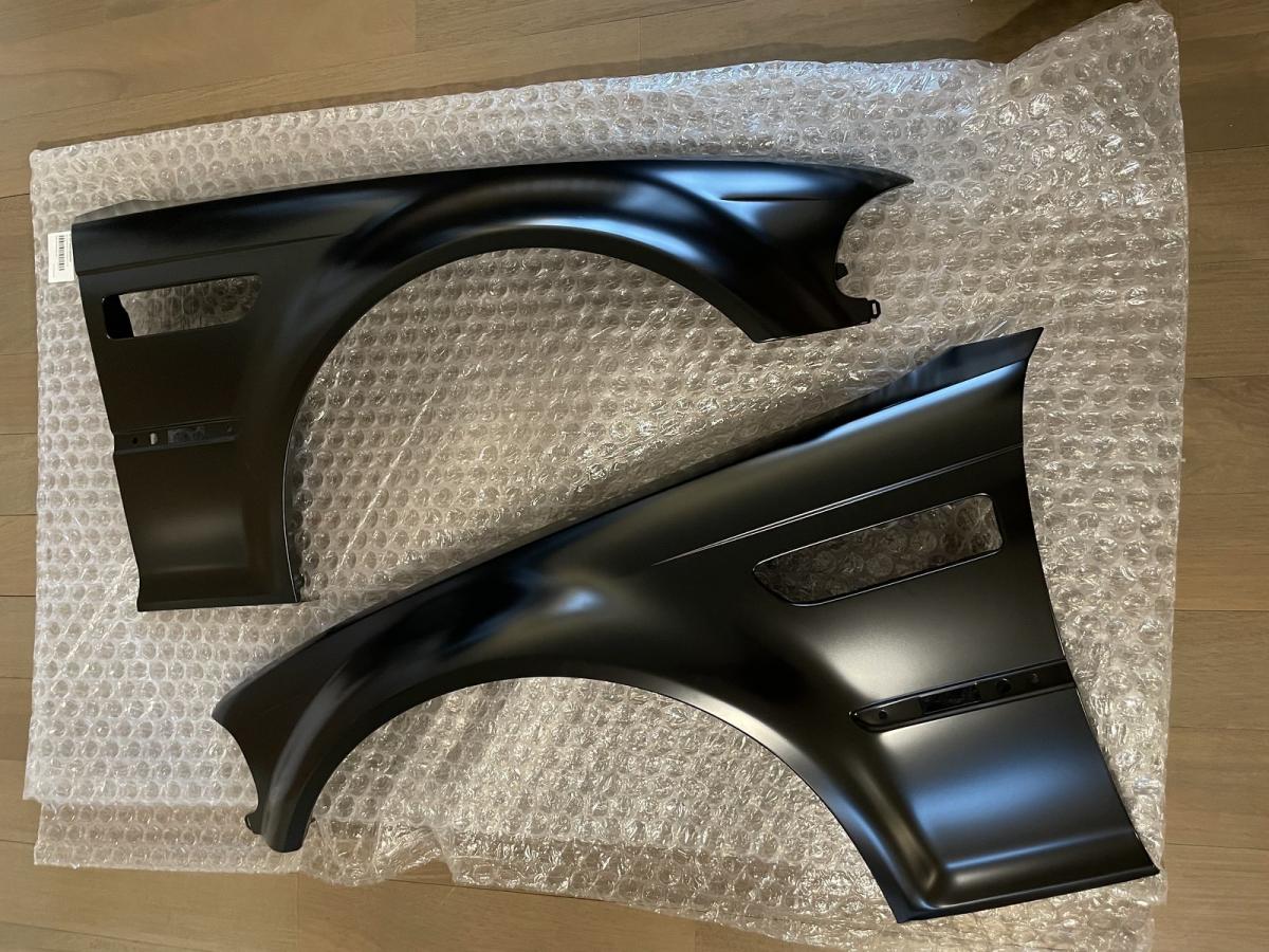

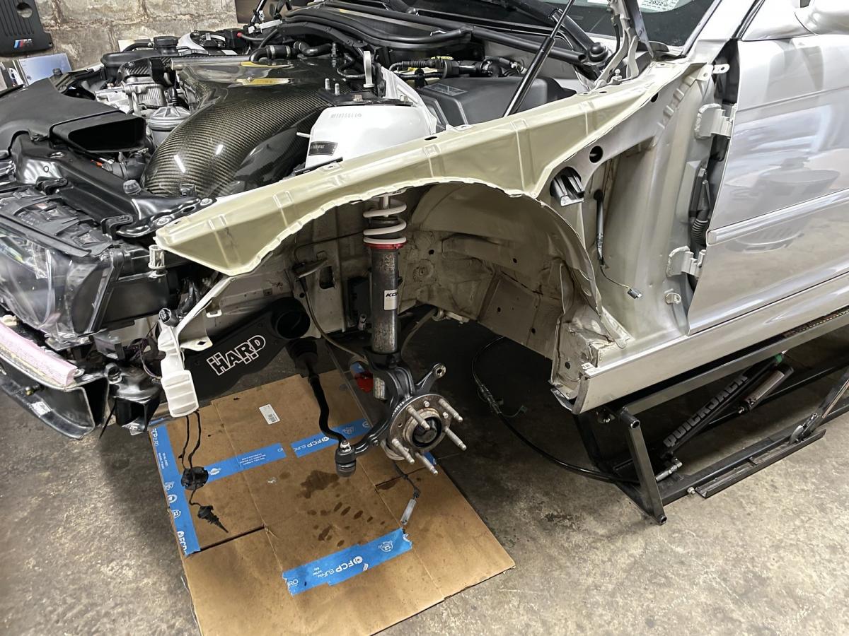

                    I also updated some body work over the winter. Both original fenders were a little banged up and also decided I didn't love the vented hood look. So new hood and fenders! It turned out the cheapest and most convenient way to order these parts was from Schmiedmann in Denmark. Even with the shipping costs it was still cheaper than anything domestic. I had them hold the parts at UPS and picked them up with a UHual trailer! I considered aftermarket CF fenders/hood but honestly care too much about fitment. So stuck with OE.
                    Old parts off the car:
                    New parts on! Not easy installing a hood by myself but managed to get it done without damaging anything...

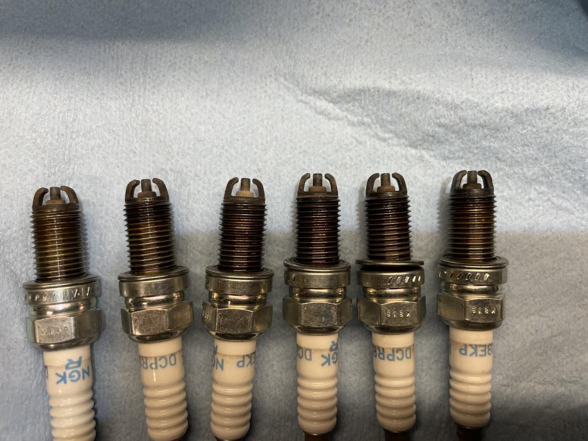

                    Everything fit really well without much adjustment. Finished it all off with some basic engine maintenance, valve adjustment/plugs/oil/etc! Everything looks good.

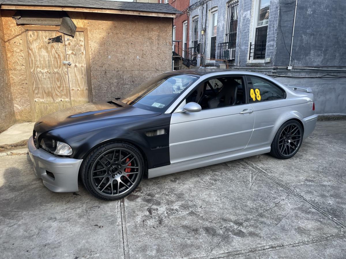

                    With it all back together it was time to head over to Ivans for an alignment. He has fist come first serve on Saturday morning and it basically turns into a Cars & Coffee with everyone trying to get their track cars back together 😂. First impressions of the new setup are great. Looking forward to getting on track this month as soon as I can get the whole car vinyl wrapped in a new color next week!!!

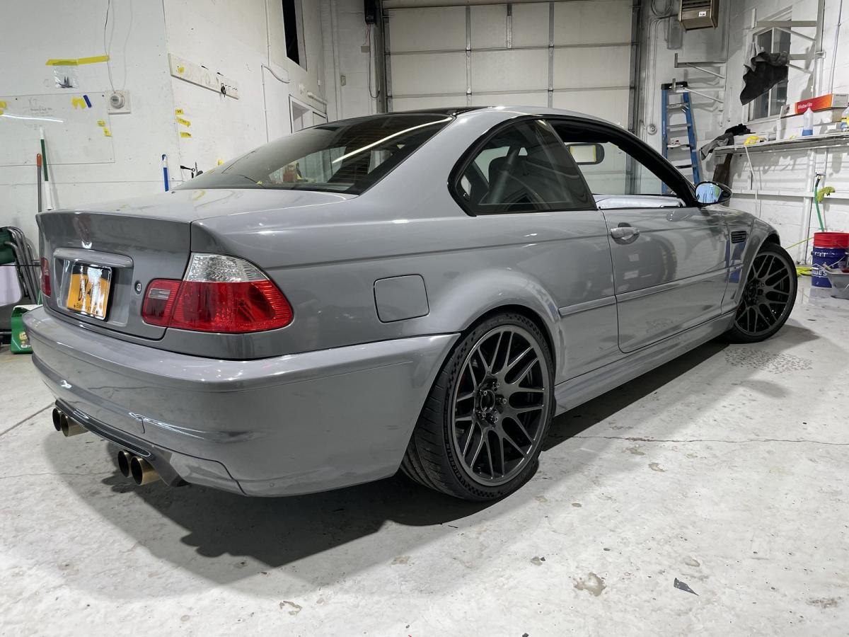

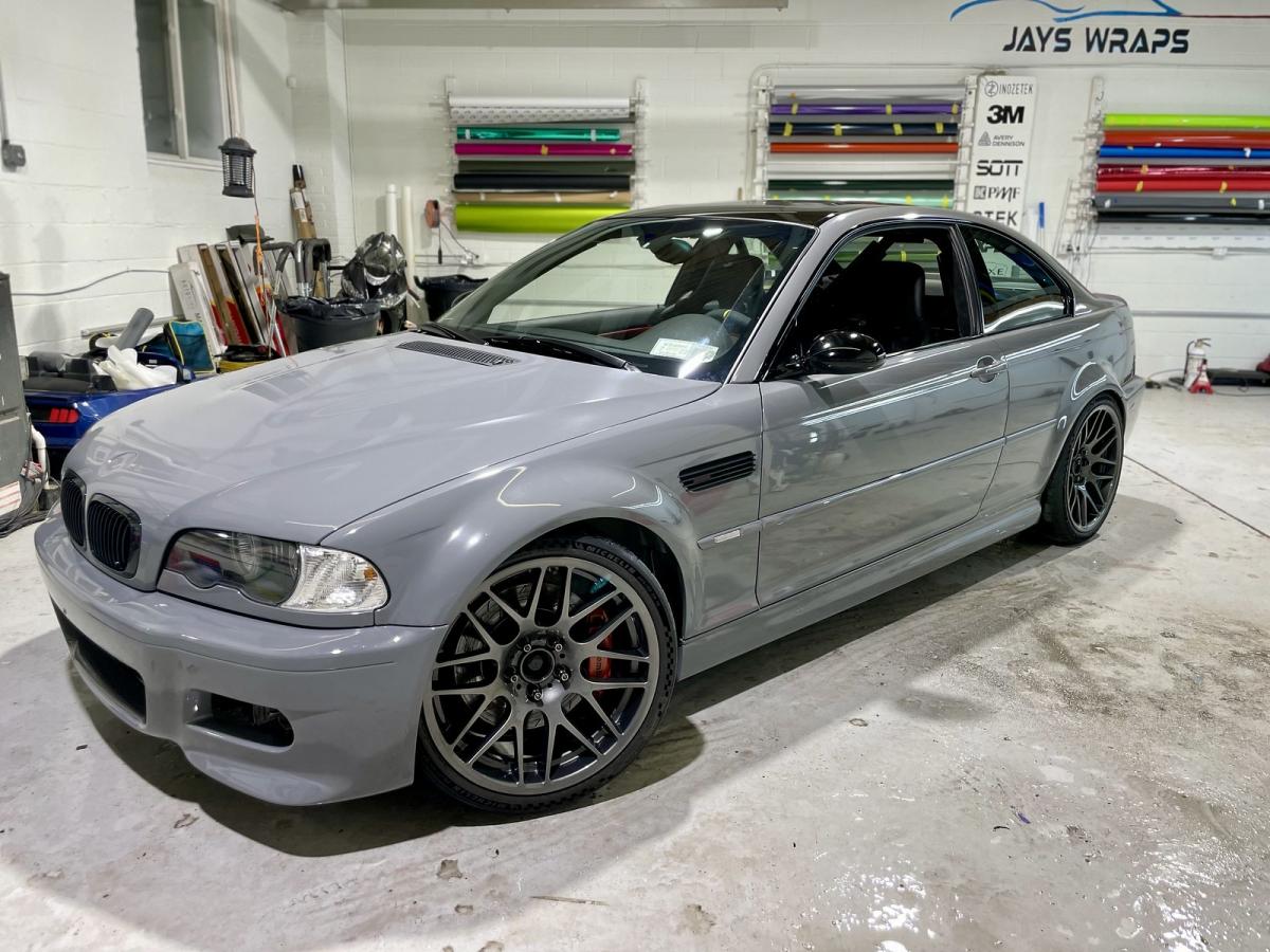

                        Got the wrap done! Originally wanted to go with British Racing Green but the local shops were out of stock and couldn't source the color. So went with my second choice Nardo Grey! Also has the front bumper PPFed to try and hold up better on the track. Wrapping the wing was overly complicated so I decided to just get that painted gloss black to match the rest of the trim.
