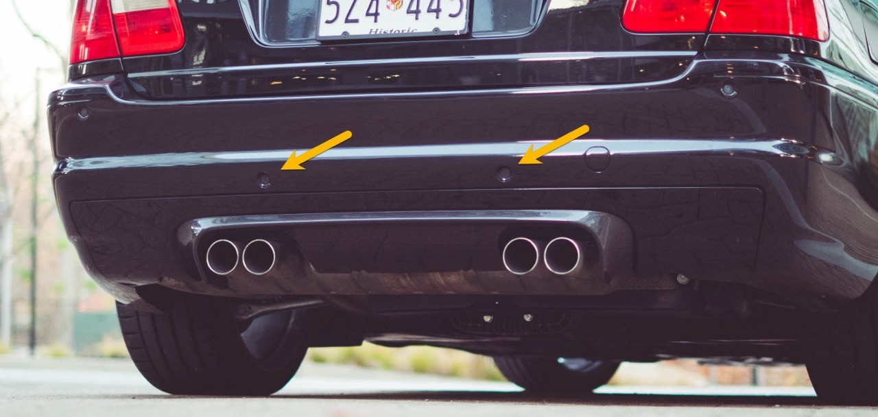

    eek get a new bumper would be costly lol....may if it works I just disable PDC or disconnect the two lowered centered sensors?
    PDC won’t work if you disconnect any sensors. Disabling is easy enough, just pull the fuse. If yours was a retrofit, I’m not positive on which fuse would have been used but the factory one is fuse 24
    I’d be looking into angled sensor inserts to point the middle two upwards if I were in your shoes. Good luck.
    You should also let M3Projekts know that this is an issue after you verify so he can move them into the factory location (higher, bumper beam height) on other future conversions.

    Yeah, that’s probably because the sensors are hitting the ground. Jack the rear up and see if it goes away. If so, you can either find a way to angle them up or … get a new bumper

    Originally posted by puma1824 View Post
    When I go in reverse the PDC is acting like there’s something behind the car.

    By alert do you mean just one beep when you put the car in reverse, or do you mean PDC acting like there’s something behind you?
    Japanese (maybe some other markets?) had an extra wire to the PDC module to beep once when you put the car in reverse. If your car was retrofitted by creating a harness from WDS, it may have accidentally had this wire run. You can just unplug the correct wire from the gong above your feet if that’s the case.

    Actually, maybe lol...I keep meaning to troubleshoot why I get an "alert" whenever I go in reverse.

    Oh cool! No false signals from being so close to the ground?

    Actually they were relocated. It's just hard to see in previously posted pics. See here:

    Does your park distance control still work with only the two side sensors? Just noticed that the middle two aren’t present.
